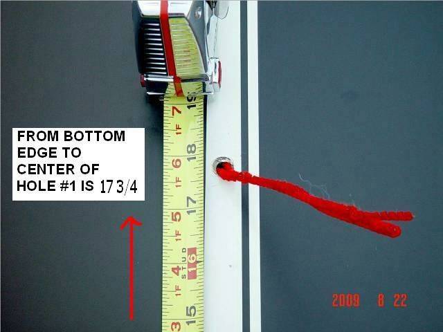

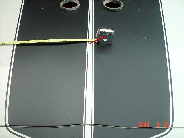

ok i have now added some more information on here. many of you were looking for more measurements, placements, ect...for 73 and up scoops on the raised center hoods like for a duster or dart sport. well i now have some more inforamtion reguarding these hoods. i took these measurements form my sons 73 dart sport 340. it is a factory hood scoop car. the scoop was taken off to repair a crack so i figured now was the time to break out the camera and tape line. these measurements again are from a 73-76 dart hood. i would imagine these would be good also for a 73-76 duster as well but don't hold me to it! what i did was took measurements from the left side only. this is done for time and because you can take the same measurements and switch them to the right side just as easily. as many before have said this is a simple guide. a template should be made from the scoop and the dimensions transfered to the hood for better understanding and placement.
ok the first couple of shots are showing the hood in question. a 1973 dart sport hood. it is a full shot. the next shot is for reference and the last is the first hole starting from the bottom center of the scoop measured from the bottom edge of the hood. the last is the same hole measured from the left edge of the hood to the center. i call it hole #1

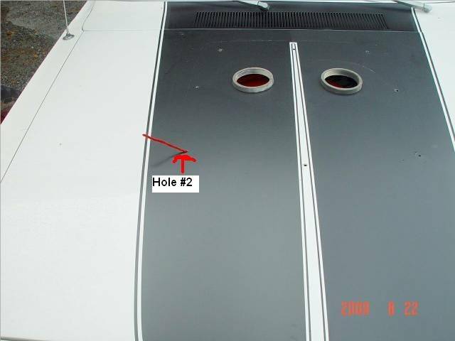

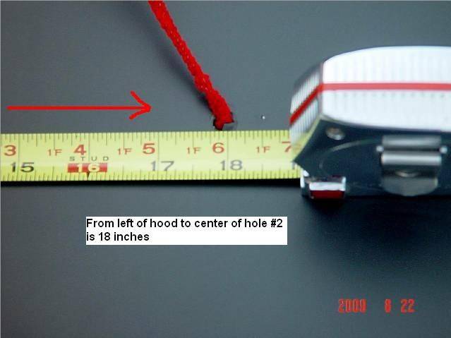

next we have hole #2. the first picture is showing the hole in question. the next is measured form the left edge of hood again to the center of the hood. this is followed by the hole measured from the bottom edge to the center. i again call this hole# 2.

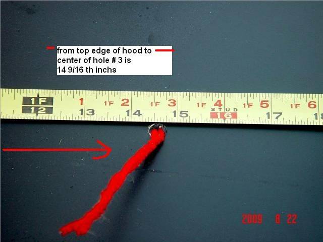

next we have hole #3. the fist picture again refrences the hole in question. the next picture shows the measurement to the hole from the left edge of the hood to the center of the hole. the last picture shows the measurement from top edge of the hood to the center of the hole. again this is hole # 3
