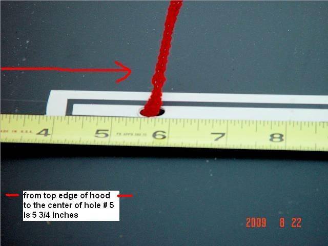

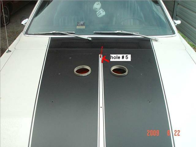

the last pictures are for hole #5. it is the top center hole for the scoop. the first picture shows the holes location. the next picture is showing the measurement form the left edge of the hood to the center of the hole. the last picture shows the measurement taken from the top edge of the hood to the center of the hole. again this is for hole # 5

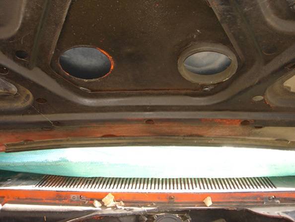

To throw another wrinkle into it all, '72 Dart Swinger 340 Specials got them as well (not just the Demons and Dart Sports). Although only 65 were made, period, they are the only Swingers that got them. They were factory installed and functional (as much as ma mopar ever let them breath on A bodies) and as you can see, when the gasket was removed, you can see the EV2 paint on the inside of the holes. There is only one restored example of these cars but of the 9 known to exist (still looking), they all came with the dual snorkel scoop. Here's a few pics of my '72 Swinger 340 Special after I pulled it out of the elements (it's very rough as you can see) but took these pics before it was stripped and bagged, ready for resto. Also, as you can see, there was a 340 badge on the scoop but that wasn't where the factory placed them - if you look down and just behind the hole for the front side markers and in front of the fender well, there are a couple holes where the factory place the 340 emblems. Anyway, just another interesting aspect of this whole Mopar thing we love, live and breath.

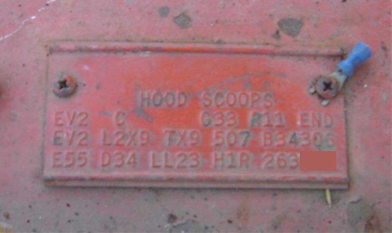

Please continue pondering, stirring the pot and wondering what the heck did the factory do - or not do. Here's another possible one-off that has shown up and I don't know the full story, but here goes. Now, I know this isn't the dual snorkel scoop and hood but it's yet another twist to the scoop saga. This is the fender tag off of Daryl's '71 340 Swinger from the 40 Crosstown Motors batch (Edmonton) and as you can see, HOOD SCOOPS is printed on it. The few cars that got hood scoops had this stamped because most of the Edmonton cars came without. The 25 Crestview Regina cars all came with hood scoops so it wasn't indicated as on any other Mopar but these few (there's only 2 documented) that got the scoops had this from the factory. Has anyone seen this stamped on a tag? As far as I know, all the '72's came with the J54 hood/scoop but non are indicated - on the 4 broadcast sheets of the 7 documented survivors that exist - in the sport hood box.

That '71 340 Dart is a rare piece, on it's own, even seeing the E55 on a '71 Dart fender tag. These were special order cars, Chrysler Canada's version of COPO.
Yeah, they were pretty stripped down - right down to the rubber mat floors but boy could they scream! The much coveted Y39 special order code is pretty awesome too, kinda' adding to the COPO/Mr. Norm thing – and in fine Canadian fashion, we didn't say anything...

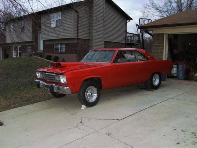

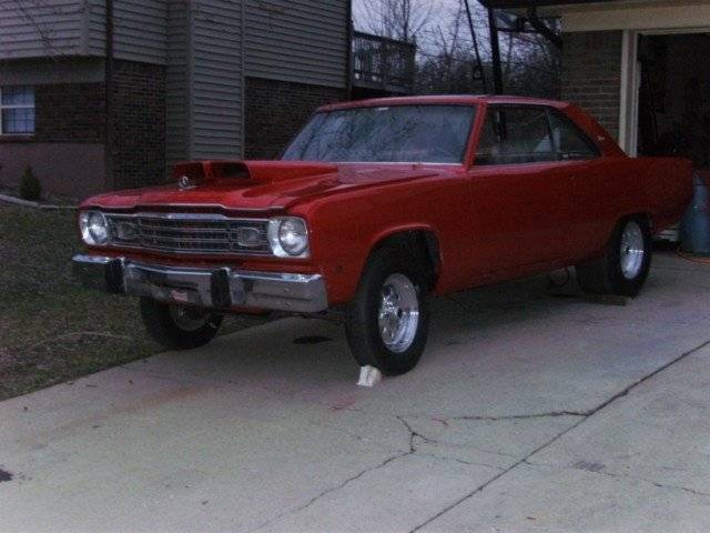

AAR makes a hi-lift version! I love it, but it might not be for you. Sorry the pics are so crappy
