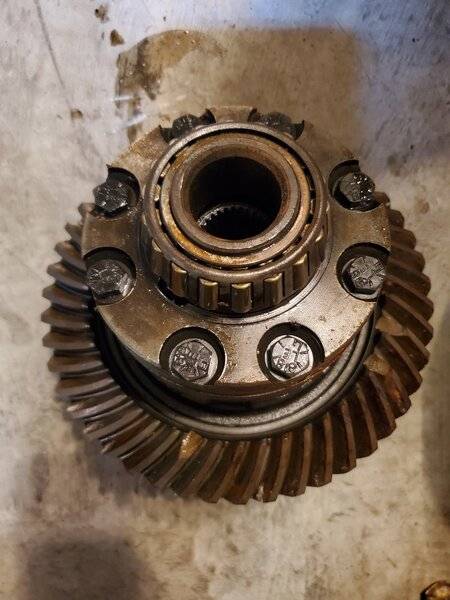

The scrapper guy called me a couple weeks later as he'd come across a 3rd member which was reported as a 742 case, open diff, with 2.76 gears. It turned freely in one direction, but the other direction there were some sticky spots that took a good bit more effort to turn by hand than the free spinning direction. It was only $50, so figured it was a good starting point.
Upon looking closer, I did see the ring gear has some chipped/broken teeth, so I decided to tear it apart, replace gears, and rebuild before putting in the car. It came apart much easier than expected, for once.
My questions are:
1. Is this actually an open diff? It doesn't really look like the open diff pics I've found online and looks more like the sure-grip ones?
2. Is there a way to test the diff for damage other than simply rebuilding it all and getting it in the car? I'm putting together an order to Dr Diff for the new gears/seals/bearings/etc. I'm torn on whether I should just go ahead and buy one of his sure-trac units and replace this one, or if there is a test to confirm this one is good. Again, the 225 doesn't "need" the sure-trac with its "overwhelming" power (lol), but I don't really find any new/rebuilt options for replacement open diffs anywhere- it seems everyone wants sure grip so that is what is available.

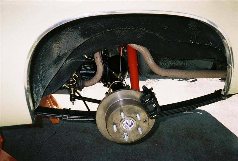

I upgraded my '68 Barracuda's stock rear end with a complete rebuilt A-body 8 3/4 rear end I bought from Dr Diff. It came on a pallet and bolted right in complete with Dr Diff's Econo Rear Disc Brake Kit, sure grip with my choice of gears and aftermarket axles.
I also run a pair of passenger side 3200 lbs Super Stock Springs, properly fitted slapper bars, a rear sway bar, Koni shocks, 275/60-15 Nitto Drag Radials on an 8" wide steelie rim.
This car tips the scales at a hefty 3750 lbs with a half tank of fuel, hooks up, rides and handles better than any Mopar I've ever driven in the past 40 years. I too started out with a 225 Slanty, but have since gone the stroker 5.9 Magnum route with just under 500hp.
I'm now about to put in an 850hp Performance Injection stroked 5.9 Magnum with a Stage 2 Paxton style blower, so I hope the rear end can hold up to that little upgrade.
That is a clutch type sure-grip. Very rebuildable as long as not damaged internally.

Thanks for the confirmation on it being SG. I thought that was the case but figured someone here would be more sure than I am.
And about the new tools things - you're right... I've found I've gotta buy something new every time I turn around on this project. I did get a press a while back to be able to do the rebuilds on the LCA's, so I've got that now. Of course, it's Harbor Freight which means its got a huge puddle of oil under it where the jack is leaking now, but I guess I'll fix/replace that too... I have watched a few vids and see that a dial indicator may end up being needed, so I'll cross that bridge when I get to it... I'll sometimes buy components for things complete, but for this car so far have been trying to do as much as possible by myself - not because of the cost so much (as the tools required often offset the "savings" from doing it yourself) but because I'm enjoying the process, time spent, learning, and having stuff to do in the evenings/weekends - I'm a single guy and my son's growing up, in high school now and has friends, so I'm no longer at the point that I've gotta be keeping an eye on the kid all the time. I do manage to drag him down to the garage a bit here and there. I think soon he'll want to do more in the garage as my dad plans to give him his '10 Challenger SE once he's able to start driving and he's pretty excited about that. I had an '09 R/T and then an '18 Scat Pack Challengers and the boy loved those, but sold and switched to the Scamp since I now have a company vehicle for daily driving.
I'm kinda figuring that out! I thought it was a decent deal when I thought it was open diff, but being SG for $50 is way better!
That would be a deal for a 742 case, let alone the good Sure Grip. You will need to have the spring perches move to the A Body distance.
What you scored for 50 bucks is a Dana Powerlock sure grip unit. That's the strongest 8 3/4 carrier Chrysler used.

I just ordered a bunch o' stuff and will plan to assemble it all on the bench before putting in the car to see if the sticky spots in rotation go away once I don't have chipped gears. I'll certainly avoid opening the SG unit unless proven necessary.

If it needs spider gears good luck finding new ones for a 742 case sure grip. They are the weak link.
Original style clutches are hard to find. 9 1/4 ' s clutches will work with slight mods. Available from Dr Diff.
