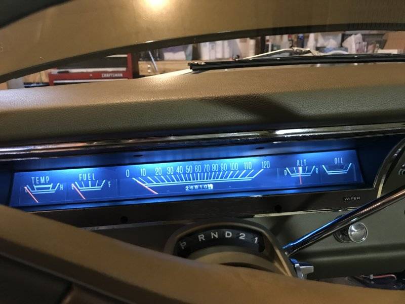

you are spending way too much money on those. I still have the ones in my dash that I posted earlier. They are dimmable and work great!! I could barely see them before! I almost bought the blue ones only because my car is blue. I didn't remove any shields or modify the dash in any way. Just plug and play. As was mentioned earlier, make sure they are in the right way or they won't light. If that happens, just turn them around the other way. I also had plenty of spares when I was done!!
