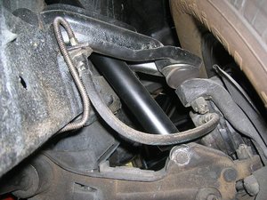

71Demon340, If you need pix of the brake hose routings I can take them for you.

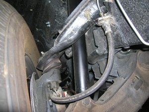

Better detail but too big to post here:
http://www.cpwclub.com/steve/auto/dart/oilpan/DSCN0009.JPG
Another view.
I'd like to see some pics of your set-up if you have the time to take them.
