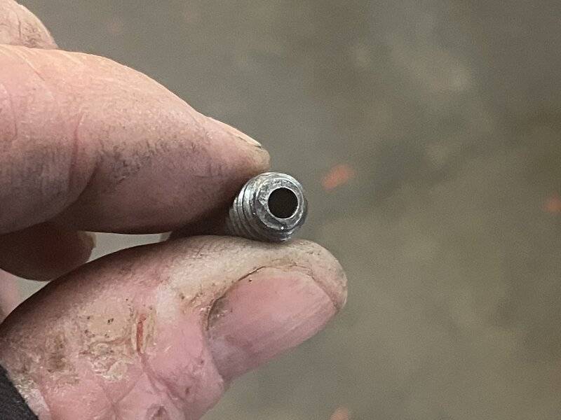

I'm thinking of drilling a bolt and using that. I have a stash of used bolts to mess around with so it shouldn't be hard to do.
Agreed, but if I had a chance to do it again, I would add the bolt with the hole on a double roller chain. JMO
Boom.

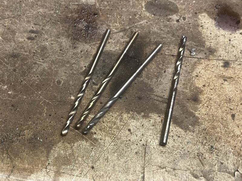

Just a few minutes with some drill bits…

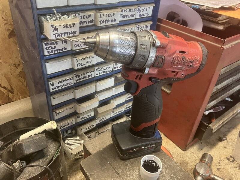

Hand held drill with a bit of 30 wt oil for a lubricant.

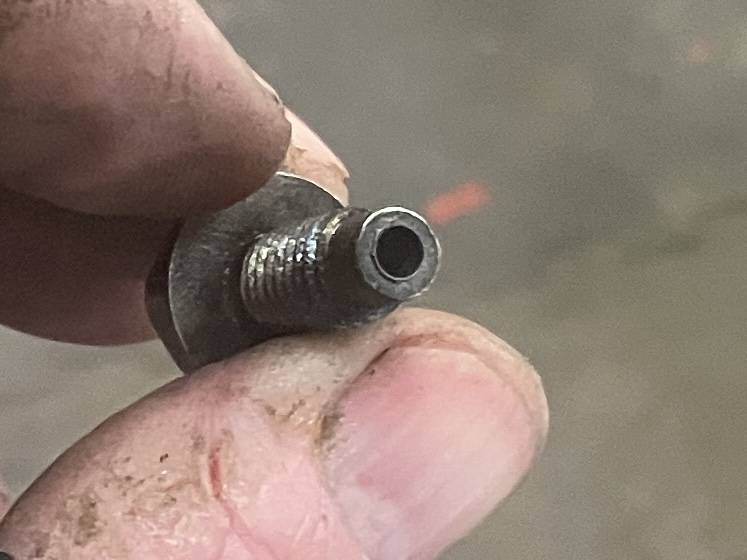

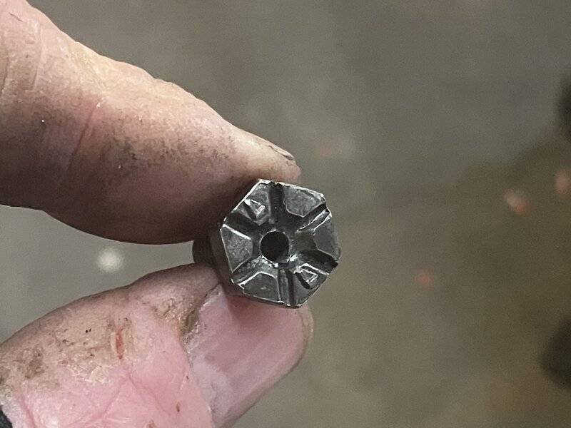

First effort…
Cost? Not a damned thing. I made four more just for fun.
