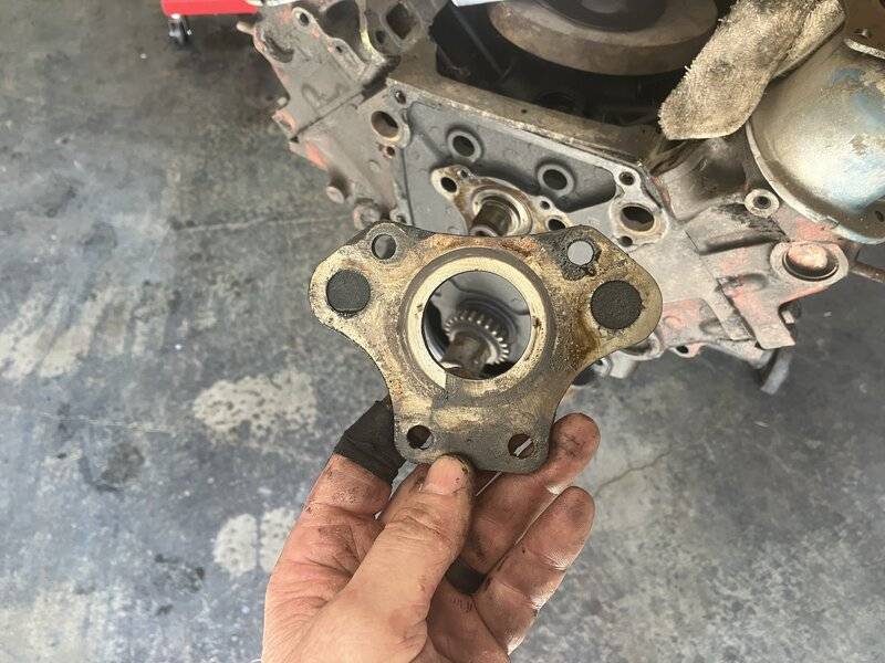

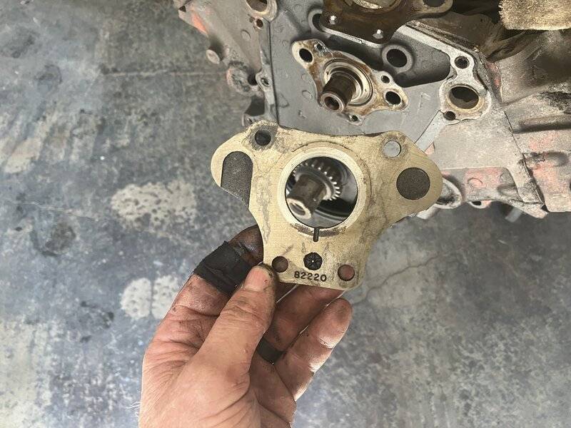

I see your point but did you see the channel in the thrust plate?
The plate from the 318 that also had no plugs:
See, the second plate appears to fully block off the flow rendering the plugs to be redundant. The first plate has that open space that surely allowed oil to flow under the plate and down the front of the block.
Again, I’m not claiming to know it all here, I’m trying to make sense of it.
Here is a closer look:
Could be that Mopar discovered that there was enough airborne oil to sufficiently lubricate the chain but didn’t think it was cost efficient to change production ?
all they cared about was it getting out of the warranty period in one piece.
if they found out they could save 1/5th of cent by eliminating the plugs and it had no detrimental effect on warranty claims then they would absolutely eliminate them.

My only argument here is that it can be done either way.......just like Chrysler did. I'd prefer blocking the gallies off with plugs on the LA and maybe drilling a small hole through the plug and plate for timing chain oiling. You could do the same with the Magnum. Just block the gallies off with plugs and use the LA plate and drill the hole in one of the plugs and a corresponding hole in the plate. In my mind, that's better oil control then the huge space in the plate that Chrysler made. I'd much prefer to divert more oil elsewhere in the engine like the crank for instance. You're missing the boat thinking I'm arguing against leaving it alone. I'm not. I'm simply saying you can do it another way. There's enough evidence in this thread already that shows the engines came both with and without the plugs......at least for the LA. I've pulled original engines myself and found plugs there. There's always more than one way to do things.

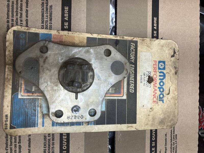

I don’t know when they started using the plate with the relief in it.
My best WAG is Chrysler was trying to get more oil to the timing cover area so they put that relief in there. The bolt with the hole in it (if it came with one because some engines came with them and some didn’t and my dad told me in 1980 when we took mine apart and it had the bolt that some didn’t have the bolt and if you wanted one you could run to he dealer and buy one…and IIRC he said it was 30 cents or something…of course that would have been in the 1966-1977 time frame), and the drip tray were IMO efforts to get more oil on not only the timing set but on the fuel pump arm and eccentric.

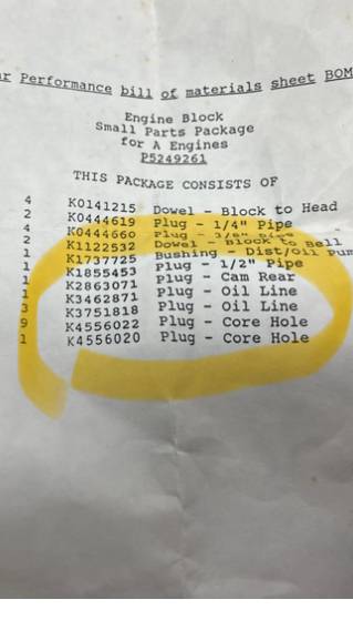

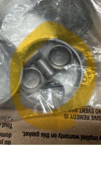

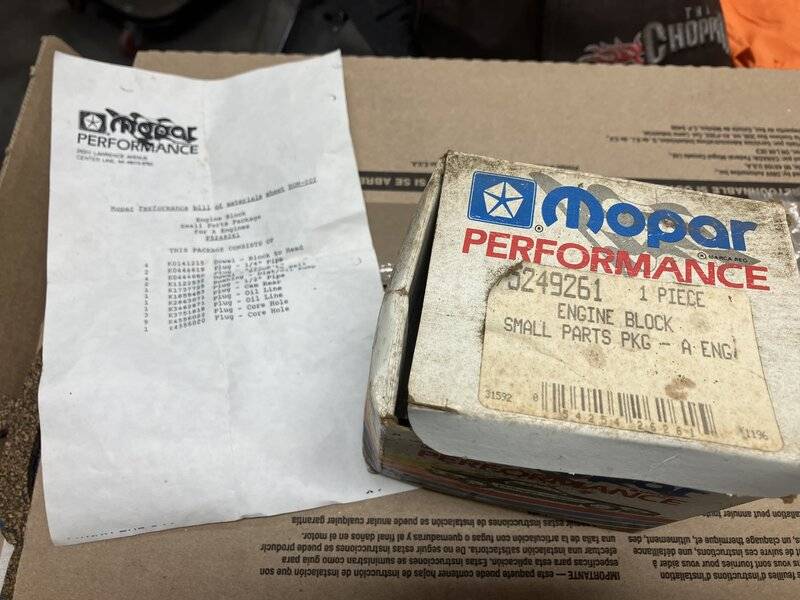

I do have the plugs in the core plug kit.
How about knocking the plugs in but drilling a small hole in the one behind the diverter….?
Put the plugs in, drill a small hole in one of them first, then drill a big hole in the plate so it squirts oil on the sprocket & chain instead of the back of the plate.
I drilled 0.5mm holes in both plugs - one aimed at the fuel pump eccentric and the other at the chain. You can use a punch to set the angle of the hole in the plug if you want to aim it at a particular area
I would put the plugs in and use a standard thrust plate ( like your 318 plate.) Pick up a factory bolt with the hole in it for oiling. All bases covered. You could even add the little drip plate to have oil drip on the chain. It seems that Chrysler wanted a little drip in that area. If the plugs help divert oil up toward the lifters, that a good thing.
That is what I'd do. My plate was nice and smooth with no reliefs and my plug kit did not have them. If it did, I would have installed them. It seems to me Chrysler was using some idea's on how to give the chain some extra oil on top. JMO Good luck with your build. :thumbsup:

In theory, it would seem redundant and pointless to have the plugs in place if the thrust plate looked like this:
Seriously, do you see oil getting past this?

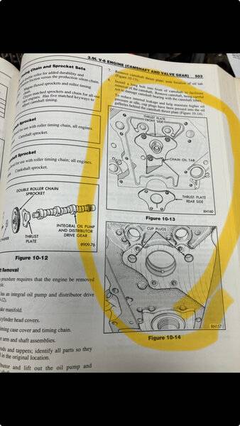

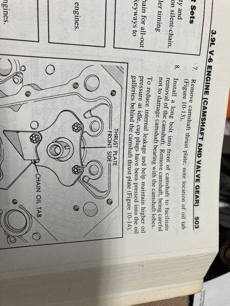

So, I was thinking. I went back to the beginning of your post. The second pic is from the Magnum engine, yes? "Knowing" how manufacturing works, the 3.9 Magnum V6 came with a timing chain tensioner. Now here's where I put too much thought into it. That void would allow oil to spill onto the chain. Reason they did it on the left side is the chain would pull it around and up the other side onto the tensioner slide. If they did it on the right side, the chain would pull it AWAY from the actual tension side. So, if the made this special for the V6, why make two different versions. Just use the 6 on the 8. Idfk.....
All of the pictures in post #1 are with a 1968 318 as shown here:
I think that there are 2 pictures with a thrust plate from my 1990 360 in the foreground but the '68 318 is behind it. You can see above that the crank sprocket is the single row, stock design. 4 screws/bolts holding the plate in place with no drip tab. This engine was from a car and used in a truck so it has a rear sump pan painted blue along with the valve covers.
