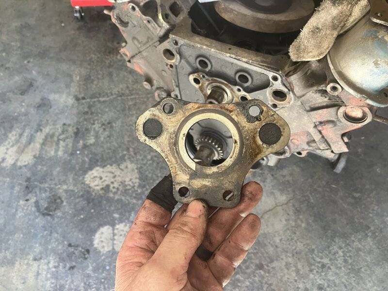

This engine never had the plugs, the bearings were fine when I tore it down a few months back so if there were a problem, it sure didn't show any sign of it. I started the thread to learn why some came with the plugs while others did not.

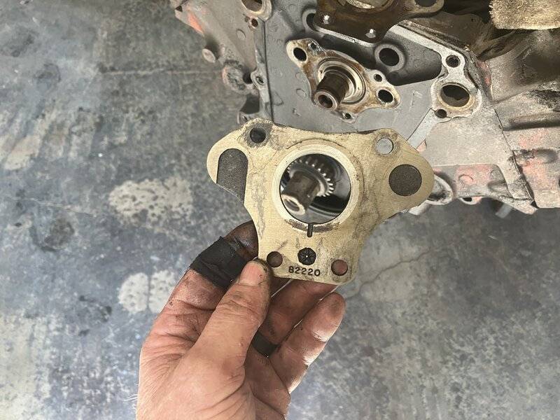

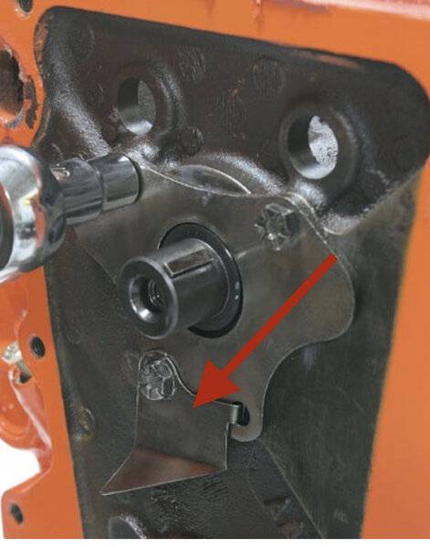

For the others here that actually know the answer......If the galleries are blocked off with plugs, why does my thrust plate have this design?
I ask because I don't know. I'm trying to understand the logic. A blocked off gallery passage would flow nothing so what point would there be to the recess on the left side of the plate?
