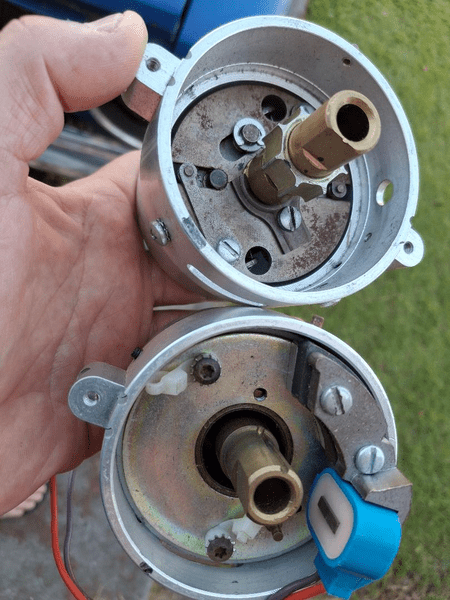

If you look at the exploded view of the Dizzy it shows what looks like the weights that comes with the original OEM Mopar distributers. The Early Mallory Dizzies that have the YL advance weights look like Mopar weights or at least the same. I like the look of the early Mallory Dizzies and have a few but the problem is I can usually only find them without the Vac Adv.
I've started to adapt a YL advance mech to a later style Mallory Housing but still need to finish the upper part of the unit. Its a bit of a mix and match scenario to be able to make it work as the heights change so that affects what button will work.

Basically the same thing I did, using an old cleaned up stock distributor from the days of F-body cop cars, a Mr. Gasket spring kit, and new pickup and vac canister from rock auto. Reading about failures stopped my shopping for a new unit.
Made by Ningbo of China. Originally sold mostly by Skip White Performance of TN on ebay. Amazing they can make them for the $45 I paid, plus $20 for an e-core coil. I bought a spare ignition module, since prudent to carry one. Main issue I've read is of an early shaft bushing failure, apparently due to no initial lube. Eventually crankcase splash oils it, but pour a little down the shaft for startup. The multi-finger pickup, akin to later GM, seems much better than OE Mopar since should account for shaft wobble as the bushing wears.

Still better to find a stock original distributor blow it apart and rebuild it. New ignition pickup, new advance can some different springs, maybe weld up the slots to limit centrifugal advance, depending on what you're going for, stab it in and done.
