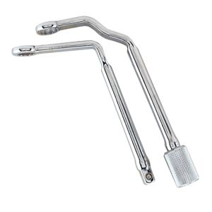

This may sound dumb but can anyone give me the dimensions for the Vim V103 distributor wrench? I am going to be making one & need the dims from the center of the 7/16 hex to the bend & how tall (or long) the tool needs to be. If you have one, please measure it up for me. THANKS!!!!!

Thought I had that one can’t find it readily. I’ve an older Craftsman 1/2” version. It’s about 1.5” from center of hex to the vertical shaft. The vertical shaft is 14” tall. The horizontal handle at the top is 6.5” wide. Hope that helps.

Why don't you just bend up a pattern from scrap..........like a coat hanger. Yeh, I know, wire ones are hard to find. What are your fab skills, can you weld? I've bent wrenches up through 9/16 and maybe larger with a good hot propane torch. That's right, PROPANE (and pro-pane accessories LOL) That, a vise, hammer, vise grips, etc..............

DOH!!! Never thought of the coat hanger idea! I've used it for brake lines etc but didn't even think of it! Thanks

The wrench isn't for the block bolt. It is for the adjusting bolt on the rear underside of the distributor.
