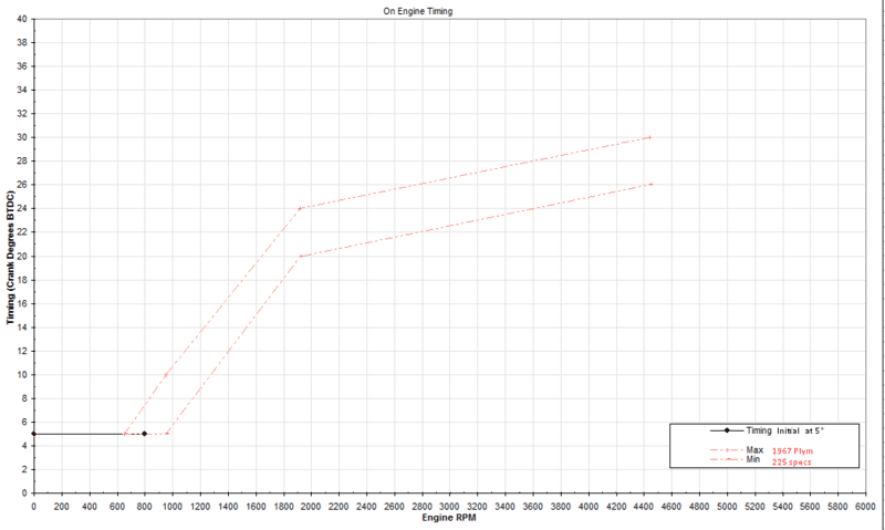

First measure what's there from the lowest rpm. (Vacuum hose plugged)
This is the 225 timing specs from the '67 Plym Manual when initial is set to 5*.
'65 might be a little different but this one will get you in the ballpark to start.
A super quick 'all in' is fine with drag race only, no vacuum advance, points ignition. Other than that, take a cue from the factory. The engineeers and techs didn't just pull these advances out of thin air.
Plot where the timing is with your distributor.

Update fixed the issue! after i verified TDC i found that i needed to adjust the bottom bracket to get my correct initial timing, then she pinged less but still could faintly hear took some timing out of the distributor 14 initial and 16 centrifugal gave me a dead 30 degrees with out V-can runs alot better!
