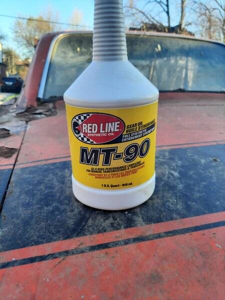

I've read about some of the horror stories but my experience with the passon 5 spd is I love it. No issues with it jumping out of gear. Initially what I did experience was a clunking when shifting from 2nd to 3rd. Clunk would disappear after a 15 to 20 minutes of operation. This seemed to occur in cooler weather. After talking to Jammie and trying to figure out what was occurring, this included removing Trans and taking back for inspection. Nothing apparently seemed to be wrong. Same result, clunky at times when cold. Shortly after this they came up with a different type of gear oil and it cured the issue. Can't recall the brand or type at the moment but I have it documented. As for the price, yes it's expensive but so is everything else today and tomorrow. Was a bit of a pain in the beginning but I'm happy and glad I went with the 5spd. Running 3:55 rear gears and cruises effortlessly at 75 mph and up. I drive the duster 7 hrs to Carlisle and other long distance cruises. Hopefully if you purchase one you will have positive experience also. Good luck with your decision.
Please let us know which oil cured your problem
This is the product recommended. Seems to have cured the problem.

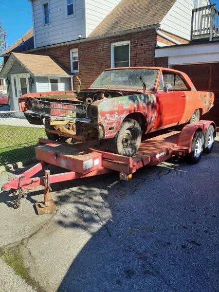

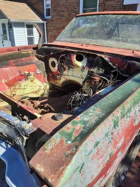

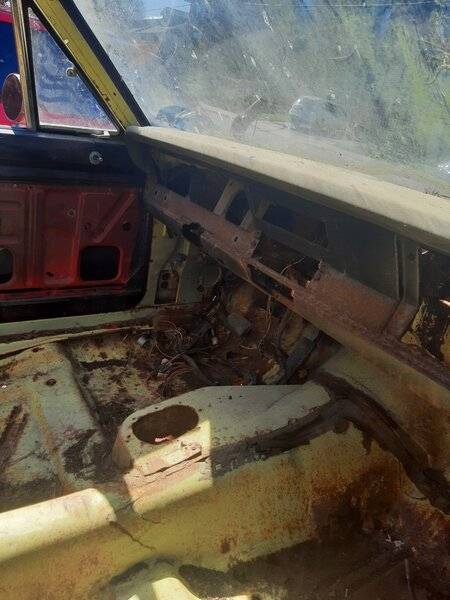

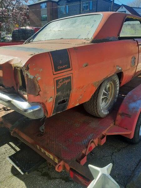

I am to the point where I am going to put my 71 Dart together. I really want the Passon 5 speed but they seem as though they aren't going to be available for quite some time. I was thinking about putting an aluminum 4 speed together with the Passon 18 spline OD kit but would prefer the 5 speed. The OD kit is also not inexpensive so even though the 5 speed is quite a bit more I would rather bite the bullet and spend the money on the 5 speed put it in and be done with it. What I would like to know is has anyone run both the Passon OD unit and the 5 speed to let me know if the tradeoff is worth or not worth the difference. I do plan on driving the car alot and only want to do this once.
