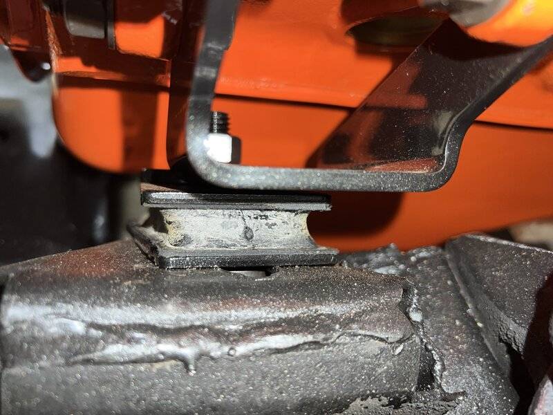

Could it be whoever bolted the biscuits to the mount put them on upside down?
A trained eye would spot that in a picture quite fast

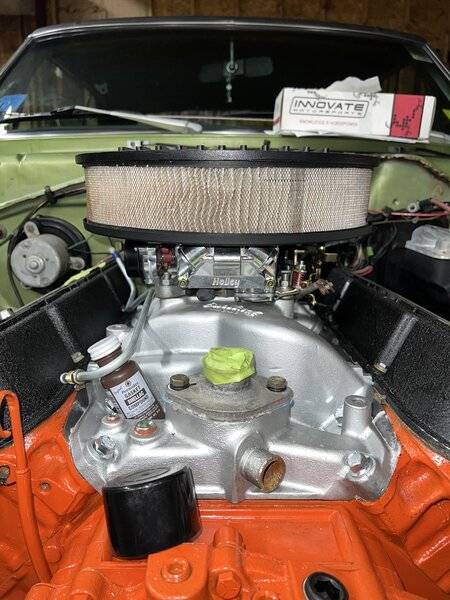

Yes it is a Mancini drop base from the MP air cleaner. It
Dropped it 3/4”. I would love to find a thinner air cleaner element

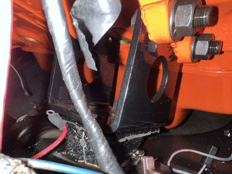

From the pictures it looked like the two mounts were different sizes, is that true ?
And when they are installed, is the locating nub on the top or bottom?
Something seems a bit off with this. How tall is that air filter?

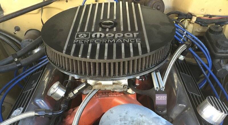

I run an Edelbrock air gap manifold which should be the same height as the LD340. I run a drop base air cleaner that has .625" of drop and a ~2.5" tall air filter element, with a holley 750 double pumper and a 1" tall spacer between the intake and carb. I have the same MP air cleaner lid and a ‘71 Dart hood. And I have the later factory block spool mount K. I don’t have much clearance, but nothing hits the hood. So you shouldn’t have to cut the hood to get that combination under it.
This is the air filter in the picture, I’ve also run a Hastings paper filter but it looks like they’ve discontinued that part number.
K&N E-2865 K&N Washable Lifetime Performance Air Filters | Summit Racing
Veryfast, that's not a Drop Base Air Cleaner assembly. That's your other option. You should be able to use just the bottom of a Drop Base assembly to drop it down, and use your black Mopar (top) Lid.
Yes it is. It’s from Mancini racing for the MP top
