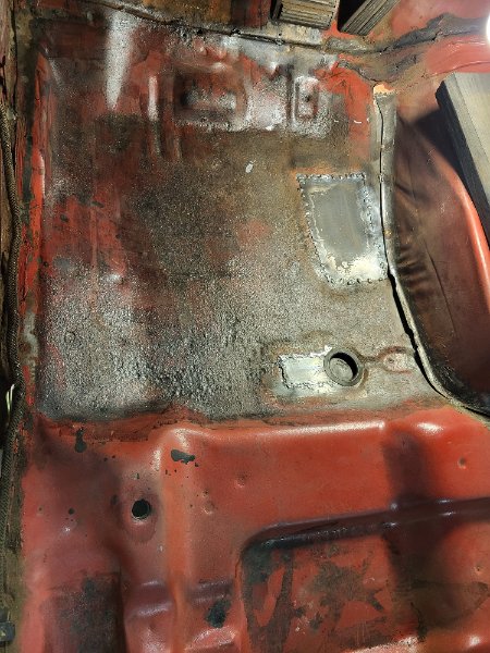

On the drivers side floor now, one big patch and another small one.
I did pick up on one trick today.
I start my arc on the good metal, build a little puddle and then move over to the crusty metal.
Worked a LOT better, didn't blow holes as the metal was getting hot as I moved over.
Maybe this is something every welder knows, but I didn't.
Here is the drivers floor, I will cover it all with seam sealer tomorrow.

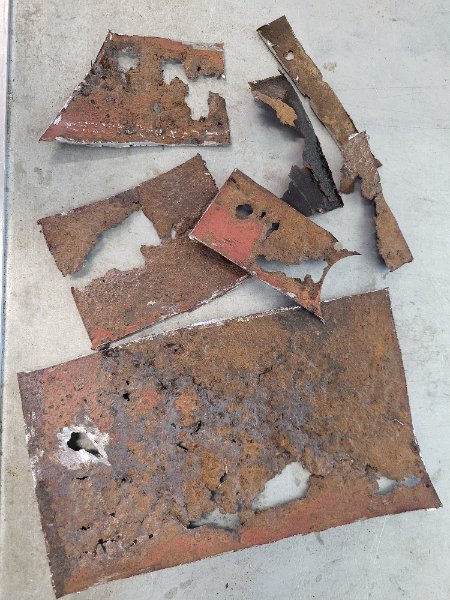

Floor paper, I have seen worse, but there were a couple of rough places.

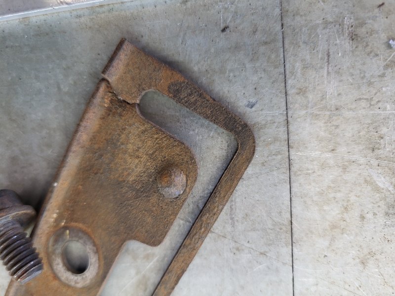

I removed the drivers side caliper, stuck!
PO used up this old car.
Imagine if he had been driving it these last 15 years!
How do you break a caliper clip?
