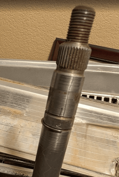

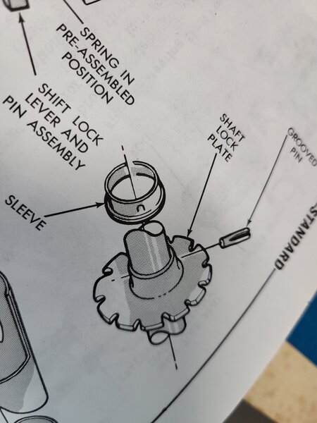

First and almost depressing, I broke this little circlip.
It fits in front of the lock wheel in one of two groves.
It's not shown in my FSM.
So I clipped in the second grove closest to the top of the steering shaft.
That was incorrect as it would not let the upper bearing go in.
So when I popped it out, it broke.
But for the life of me, I do not see what it does.
So I left it out, not that I could find another if I needed to.

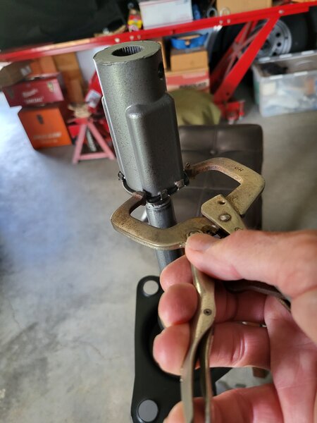

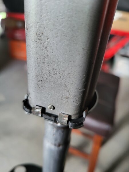

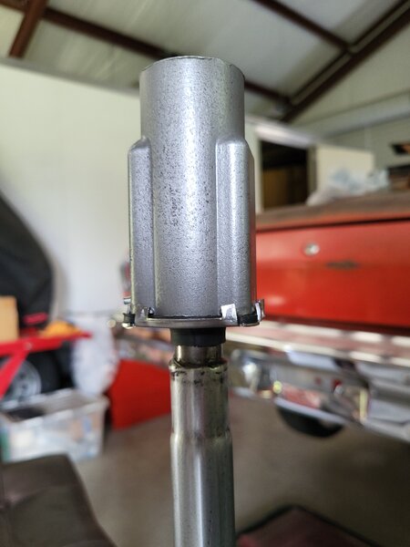

Got the coupler mounted.
Packed it about half full of grease.
I used my welding vice grips to pull the little tabs in.
I put the little pin back in because I would have a hole and I think this should hold the thing together.
I made sure the coupler will slid on the splines before I assembled everything.

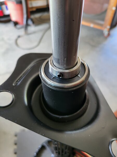

Also a better picture of the lower column support bearing.

There is an alignment mark on the shaft that should line up with the mark on the coupler and on the master spline on the gear input shaft.
Also there is a spec for the amount in or out of the coupler the shaft should sit, adjusted by the clamp at the bottom of the column and slots on the dash mount bracket
I have all the splines lined up.
Didn't know about in or out, I was going to put it back where it was on the dash.

But what does it do????
keeps the shaft from coming out the top of the of the column
There are 2 snap rings that are on either side of the upper steering shaft bearing.
They and the bearing retainer prevent the steering shaft from coming out of the column
Why would Chrysler have a snap ring above the bearing and a circlip below the bearing if it was not necessary.
They used that design from 1962 to 1977.
Later on they even used them on front wheel drive Omni and Horizon.
I am not saying it's not needed, I was just having a hard time seeing the need.
With that little pin in the coupler I don't see the shaft coming out.
I ordered a couple from DMT and I have a new turn signal switch so I will take it apart and fix it.
The little pin has a lot of movement, before it stops the shaft.
I guess the weight of the engine will keep the engine in place. :lol:
The clips trap the bearing on the shaft, the bearing is traped by the housing and the bearing retainer. No movement.

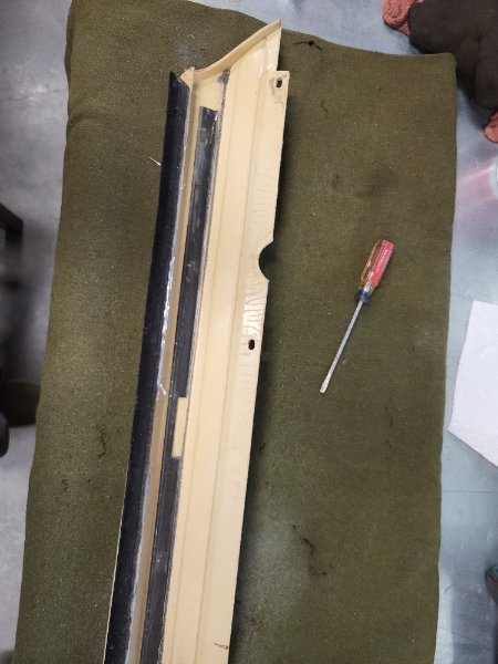

After destroying the roached passenger side upper door frame I got some good advice.
Trying to remove the old window fuzzy strips.
I broke it in quite a few parts.
So on the good ones I used a grinder and cut the steel and removed the strips without breaking anything.
I did smell some plastic once in a while, just moved over and worked in another spot.
Now to paint them and install the new inner fuzzies.

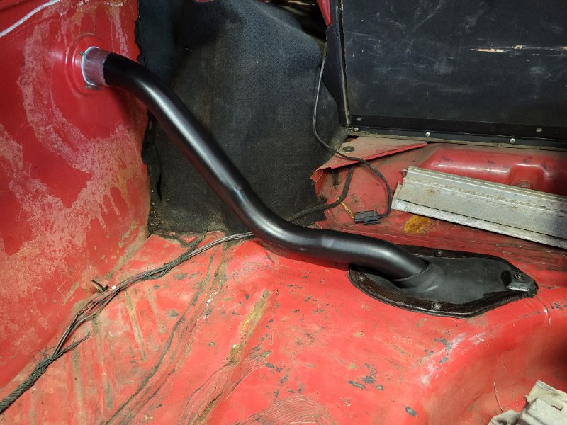

This job was bugging me.
I put the tank in and thought I could work the fill tube in after.
I had to beat the old tank out with a rubber mallet.
That was with the filler tube still in.
However the force was with me today!
I got the tube in with the tank in!
And a fold down seat has a really bent fuel filler tube.
So another job done!

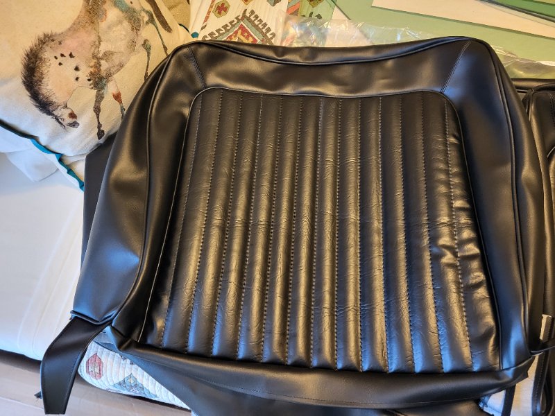

I also got my Legendary front seat cover today.
There is one small defect on the seat back top panel.
I am waiting to hear what they want to do about that.
The seat cover has been on order since July.
Legendary says, send it back and they will replace the top panel.
My interior guy said don't send it back.
He will dye it and it's under the head rest anyway.

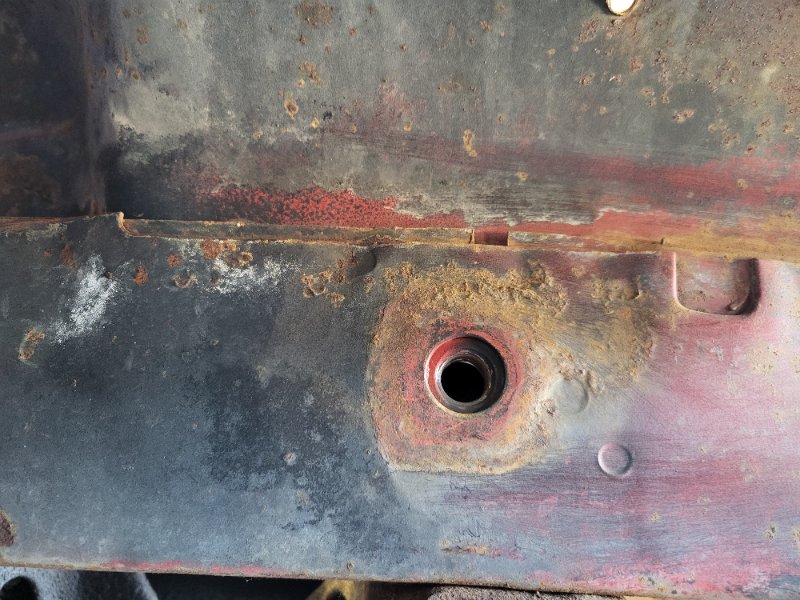

I put the drivers side up the frame rail and WOW, what the heck is that?
If you notice there is a second 1/2 round cut behind the insert in the frame.
What you see in this picture is how far the insert moved back in the accident.
Looks like the spot welds slid back inside the frame rail.
I was able to put it forward to put the insert in the center of the correct hole.
Here is the passenger side to show what normal is.
