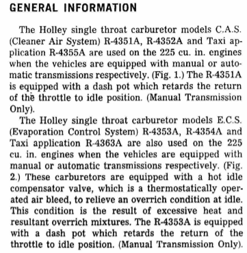

Maybe Holley 1920 in '70?
Download your year manual.....
MyMopar - Mopar Forums & Information - MyMopar Tools/Reference
From the Factory a 225 Duster could have had a Holley 1920, a Holley 1945, or a Carter BBS. what year Duster, which which transmission, is it a California car, a 49-state car, a Canada car, an export car? That'll enable an answer of what carb originally came on it, but since A-body Dusters are now between 44 and 50 years old, it won't enable an answer as to what's on it now.
