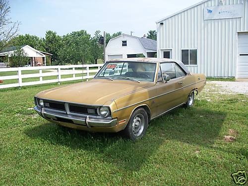

What about black primer????? i was looking to go back to the cars original color which is Y8 or a gold looking color..

Before & after primer.. the first pic is the color i am looking to put back on the car.. Y8 is the color code
Before
