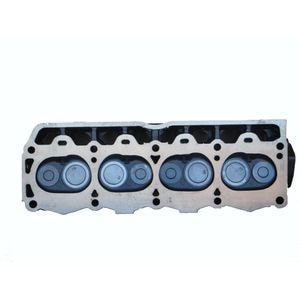

Thanks, everyone. I think what I will do is keep the heads that came on this motor, since they were designed for them.
What does everyone suggest having a machine shop do? Hot tank?
Pressure test?
Mag check?
Does a pressure test tell them if it needs a valve job or valve seals?
Pressure testing is used to check the integrity of the water jackets.
My suggestion is to have the heads disassembled, cleaned, magged, and given an overall evaluation.
However, if you want to do your own pre-inspection, pull them apart and with some carb cleaner and a small wire brush that goes in a drill, clean off all around the exhaust seats in the bowls and chambers.
Then carefully look for cracks in the seat area with a magnifying glass. Those 302 heads are rather crack prone, and if you see cracks, stop right there and move along to plan B.
Machine shop? do? with the heads? at a minimum clean them up check the guides and install guides and or liners if needed. valve job and new valve guide seals. Oh and tehy should check installed height of the springs and shim possibly or replace any weak valve springs. But I'm just yacking most here would tell ya to get Speedmasters... :thumbsup:

As far as checking your 318 302 heads for any cracks, yourself.
A good pair of eyes and a magnifying glass. If the engine was overheated at any time or run out of coolant, the crack will show up in the narrow area between the intake and exhaust valve in both valve seats. It will be quite obvious if there is a problem there.
No problems, continue on. Quick check for any excessive loosness of the valve guides using a new valve to check.
Get yourself a new set of mopar valve guide seals for final assembly.

here's my play: tearing down and cleaning/inspecting your heads costs you nothing but time. if the seats look good and the guides don't seem to have a bunch of wobble to them, then i'd see what the machine shop wants for a tank/pressure test/mag check. if that's reasonable, then go that route. then just clean up what you've got, lap in the valves, snap on seals and ship it.
any of the heads you have are viable options, i'd just choose the ones that need the least amount of effort, work and money to make right. and if any of that exceeds 500-ish, then i'd be pulling the trigger on some remans.

I called AutoZone, I have a commercial account with them and got their 2D31 for $208! No shipping cost. The warehouse only had 1 so I got it and will check back when I'm ready to install.
The machine shop wants $335 to clean, mag and pressure check. So to have these ready to go is the best play.
