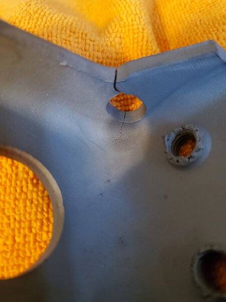

Corey,
We got your hinge cores yesterday. Today I have been able to do a partial disassembly and inspection.
It looks like they may both be hairline cracked. I will know better when I do the total clean up/polish. Otherwise they look ok to rebuild.
Here are a few pics. If the cracks are more than superficial they can be welded up since there is no gap in the hinge crack area.

Welding and refinishing broken hinges is not part of a rebuild. It adds 1-2 hrs to a rebuild as well as materials ( grinding discs, wire, etc...) We charge an additional $15. per hinge if needed. Of course you don't have to fix the cracks. Most hinges out there have this damage.
Our policy has always been that hinge cores be undamaged ( cracks etc...) unmodified ( Prior hinge rebuild attempts) Not excessively worn pins holes. Mopar only hinge cores, no Taiwan import stuff.
