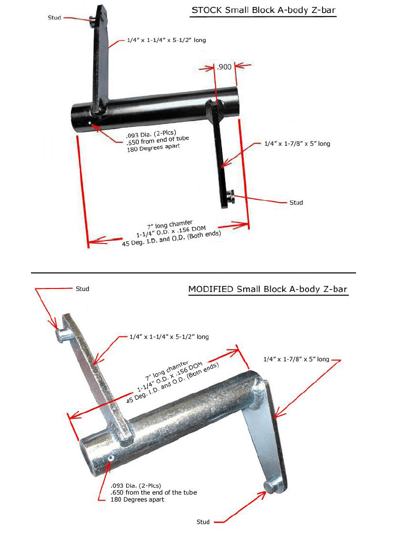

The lower linkage on the zbar is touching the tubes. it moves but is resting on the header. can I remove spacer between the bell housing and zbar with the 2 bolts or do they make a thinner one? I don't need much
Grind off the lower portion of the bar for clearance. You may need to bend it a tad for added clearance. I had to do this even w/TTI's.
Nope, not the proper procedure. I posted this in the OP's other thread already, and it's been discussed numerous times. The proper modification comes straight from the TTI website, both TTI's and Doug's instructions make it clear that z-bar modification is required for their long tube headers. TTI goes one further than posts the specs needed.
Here's what the modified z-bar looks like. Basically you take the arm for the clutch adjuster, cut it off the Z-bar, slide it down to the very end of the z bar and reverse it so that the clutch adjuster stud faces inside instead of out and weld the arm back on. It's a pretty simple operation if you have a welder. When it's done all the arms are straight and it's hard to tell it apart from stock unless you've got an original and a modified side by side.
Here's the specs on the stock and modified Z-bars. I labeled it Doug's because that's what I have, but it's from the TTI website. The PDF is below, but here's a screenshot of it so you can see the picture without a download.

So the stud in the pic needs to be moved to the inside of the bar correct?
It's more than that, the whole arm that holds the stud for attaching the clutch adjuster has to be moved to the end of the z-bar, just shy of an inch of movement as diagrammed in the picture. And then the stud has to be flipped so it faces the inside of the z-bar, but if the arm is detached to move it to the end of the bar you just have to spin it around before re-welding it.
All ya needed to do is bend the lower arm for clearance and grind a little off the end. Easy fix.
Just because that worked for you doesn't mean it will work for everyone. If it did, the instructions to modify the stock z-bar would explain exactly that. They don't. No reason for TTI to tell you how to modify a stock z-bar, doesn't make them any money. And yet they do, and that's not what they recommend. Could be it won't work on everything, could be because it negatively effects the clutch linkage alignment, or it could be that it changes the ratio since the arm is effectively shortened by bending it.

Sorry for posting on am old thread but I just ran into this issue. Aside from moving the arm over and revesing it; is there a specific angle it has to be in relation to the arm that connects to the pedal? Like arms on a clock?
You want to keep the clocking the same. So you cut the weld, slide the arm to the end of the z-bar, and flip it over. But you want to keep the angle between the two arms the same.
