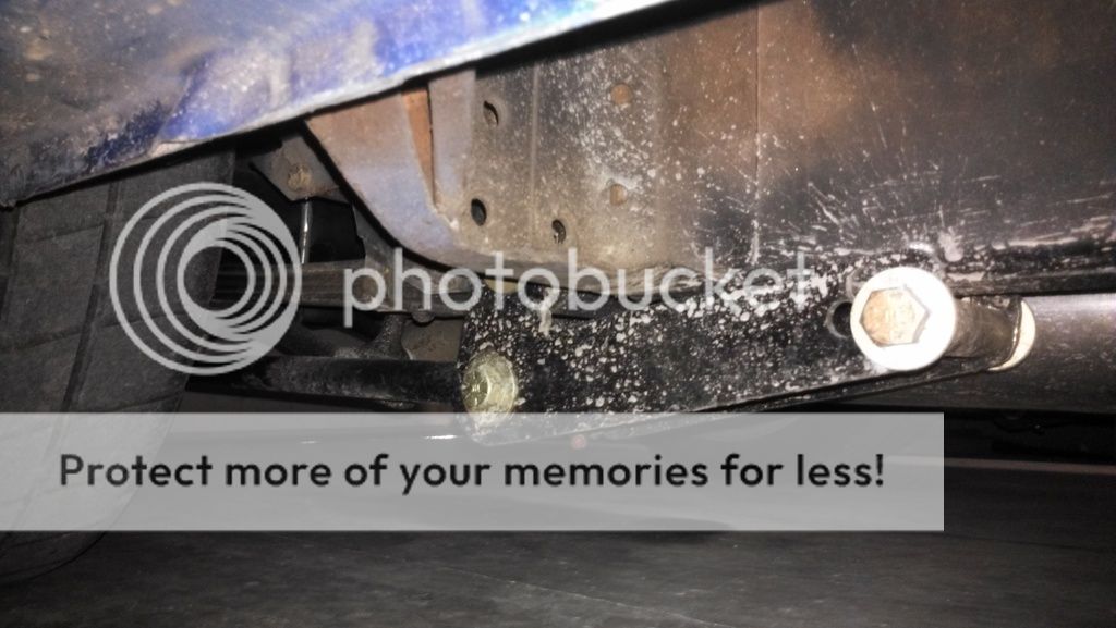

Driveline Hitting underside of floor (at rear)
The car has the Hotchkis TVS front suspension system and the matching rear Hotchkis springs. I contacted Hotchkis and they gave me the dimension from the center of the wheel to the underside of the wheel lip opening (12.5 inches) for the rear tires so I could check if the leaf springs were saggin. I measured it and they are dead nuts on 12.5". The Hotchkis leaf springs lower the car 1" from stock and that appears to be where it's at. The issue still is the Dana 60 is a much larger (physical size) rear end compare to what the car came with. Before swapping out the rear ends, I will have the pinion angle checked and make any adjustments necessary. If that checks out, I really only have the swap out option which I'm OK with. It fixes several issues with one action.

Replacing the leaf springs probably won't help if puts the rear end in the same place (vertically). I would think that if you put the car on a lift you could look underneath and see where (exactly) the rear end is hitting the body. If it's hitting where the u-joint is located then it's your pinion rising too far "up" (pinion angle). If it's hitting on the top of the center section then you simply don't have enough clearance for that differential with the body as low as you have it. You need to determine "where" the differential is hitting before you spend any money attempting to fix the problem. It should be obvious where the rear end is contacting the body. I've had similar problems and I always put the car on a lift to see where the rear end is hitting the body. You need to identify the exact origin of the problem before you start drawing conclusions.
PS - If I remember correctly you've already looked under the car and you said that the yoke/u-joints are rising up and hitting the body. If this is correct then you need to verify your pinion angle to see if (maybe) the pinion angle is set too high?? Even if you replace the springs it won't change the pinion angle?

Treblig - You are correct. We've already put the car on a lift and verified the U-joint/pinion is hitting the underside of the body. My next step will be to check the pinion angle, make any necessary adjustments before buying parts.
