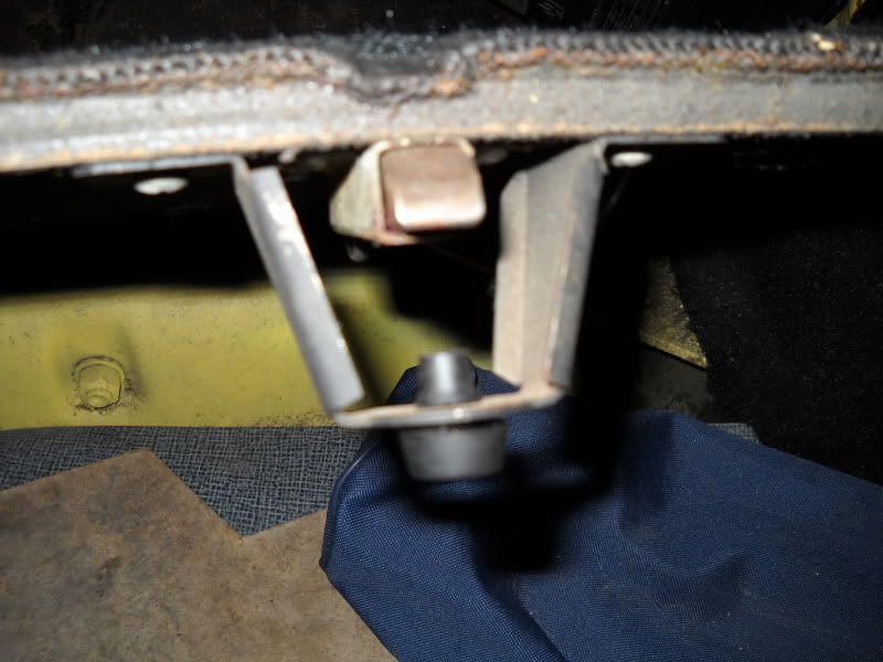

If you have a locking glove box a locksmith can make you a key for your trunk from the glovebox lock,as long as the trunk lock has not been changed.8)

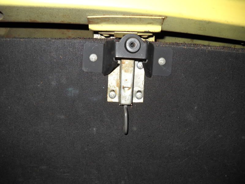

This is what you will find on the trunk side..........
If that doesn not work, you can always take the car to a locksmith and have them pick it and make you a key.
thanks for the pic. That looks like I can pick that. Not too difficult of a latch. Just didn't know what I was working with.

after snow shoveling both my driveways and uncovering cars from snow I went in and tried to unlatch the panel. I couldn't get it for the life of me.
Probably just tired and late in the evening. This evening I will try again.
Looks extremely simple. I can't believe I had such a hard time with that latch!!
You might want to try a hacksaw blade if the screwdriver doesn't work. They are a bit more flexible but real strong. Just tape up the end were your hands are as they are tuff on skin.
I got into the trunk. Thanks for the pics and advice.
Tried all sorts of tools but in the end it was the hacksaw blade that did the trick.
