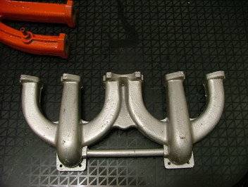

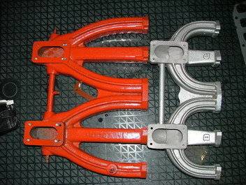

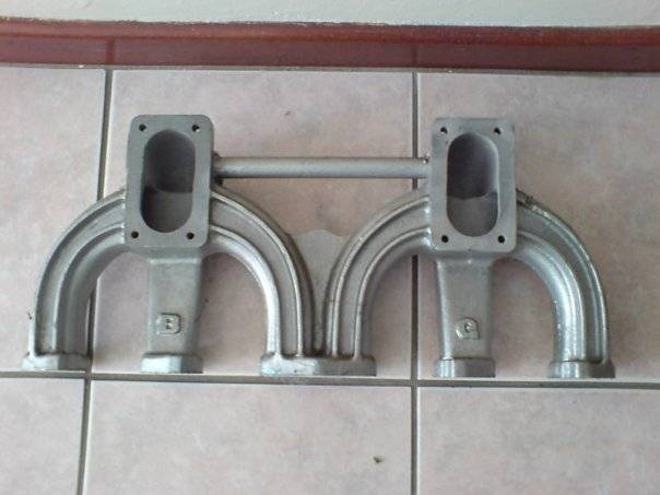

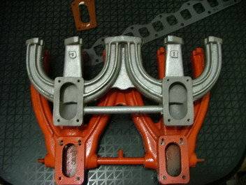

There is a true dual-plane intake for the slant-6. It's an aftermarket piece from South Africa that takes two 2bbl carburetors. The car in question here almost certainly doesn't have one. Here're some pics. The orange intake in some of the pics is another South African piece, part of a long-runner twin Weber setup.
As for exhaust: Dutra Duals with a Flowmaster wye connector into a single 2-1/4" pipe.

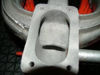

My mistake - not dual plane at all. It's that one of the intakes has the two barrels divided and one doesn't! I just looked more closely and see that the divider doesn't extend to the floor of the intake. Sorry about the crappy picture - lights are no good in this part of the garage!
Undivided one has been modified. If you're using a stock(ish) carburetor, the divided one is probably going to give you slightly better driveability.
Holy intakes Batman! That's badass!

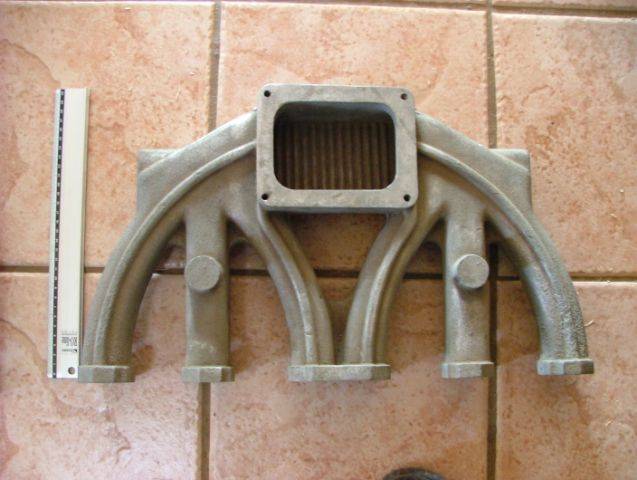

Oh, there's more...an octopus (okeh, hexapus) 4bbl intake with damn near equal runner length, that was another South African item.
This looks to me like a really smart 4bbl intake design for the Slant. Most others (Offenhauser, Clifford, Weiand, etc.) have the two centre runners (#3 and #4) running directly from the plenum into the head. The obvious problem there is that the inner cylinders get fed more than the outer cylinders. This intake seems designed specifically to provide even mixture distribution.

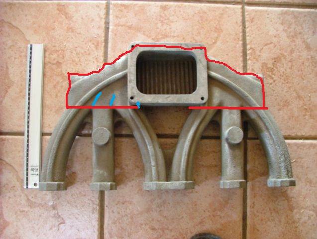

And would you know it busy being 3 D scanned - the plenum on this thing is quite interesting, with the dividers going deep in to plenum - plenum is from flat side to flatside - outlined in red - blue more or less indicates dividers
