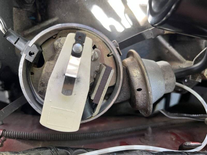

No, but on some lights the direction of the clamp, or even position on the wire can make a difference. Try flipping the clamp over, and moving it up/ down the wire.One other quick thought? The plug wires are very skinny older 7mm, and the timing light plug wire attachment clamp is pretty loose on there. I'm wondering if that might be causing a problem.
