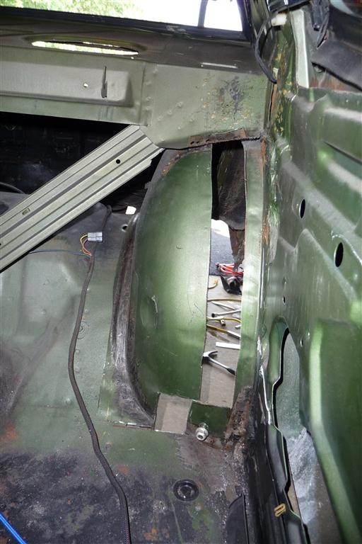

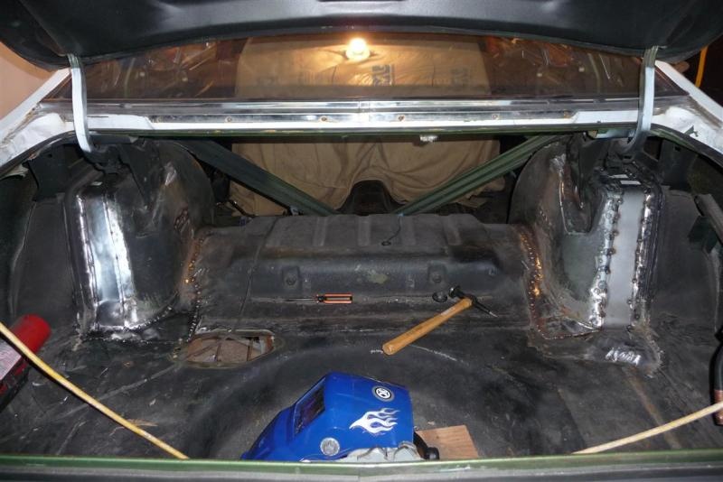

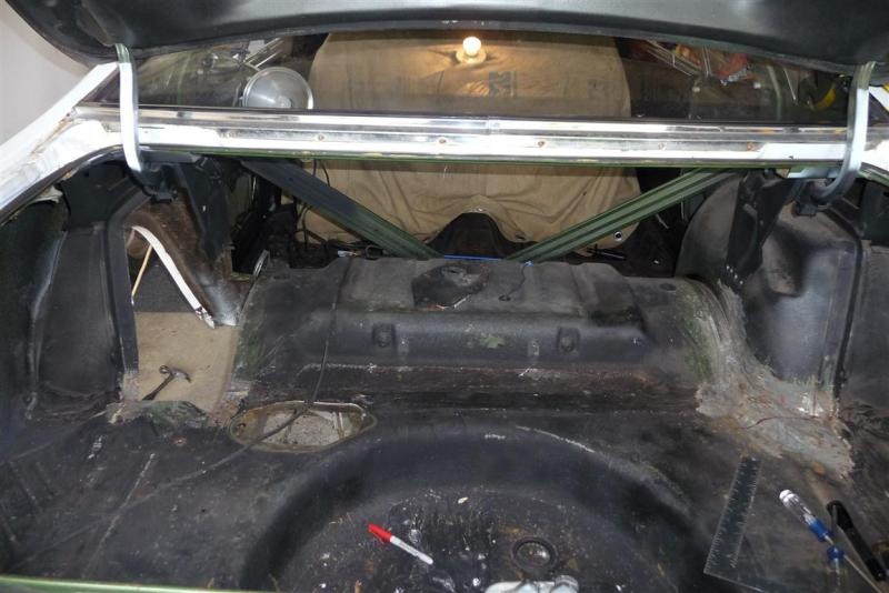

You got it, heres some pictures of the project.....

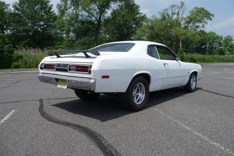

So thats it, heres a few before and after shots of the car...Enjoy.

Nice work and great pics!
Well done and the car looks great with that tire under it.
Thanks again, still need to drop the rear an inch or 2, then I'll be completely happy with it. I want the top of the tire right at the lip of the wheel well, I think that will look a lot better. Now I'm working on a nasty little 340 for the car, that way it will perform as good as it looks.
Butch
Thanks, that's one of the best shot by shot mini tub jobs I've seen. Now I got to get up the nerve to cut my car!
Thanks, it was alot of work, but well worth it. This was the first time I tackled something like this, just did some reserch and looked at some of the other guys did, took my time and I'm happy with the results.
