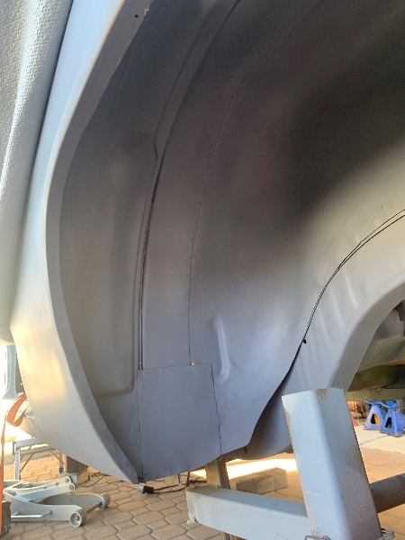

This is ns1rm21’s latest project…

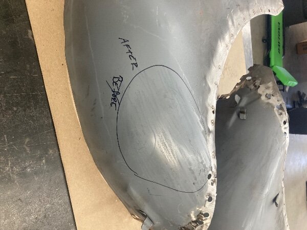

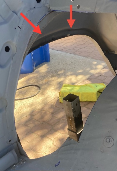

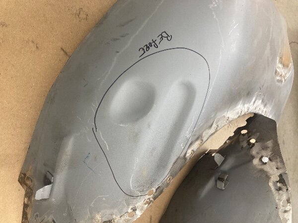

He found if you want the tire more inside the wheel well there’s a ledge in the outer wheel house you can flatten. Also some other lumps.
Before:
After:

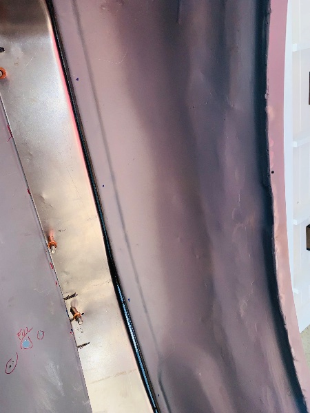

In process mock-up 275/60/15 w 15x8 (just got 15x10’s and looking at 295’s I think) :
Lumps:
Before:
After:
Lumps:

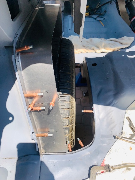

US Car Tool full reinforcement kit (but hand made mini tubs)

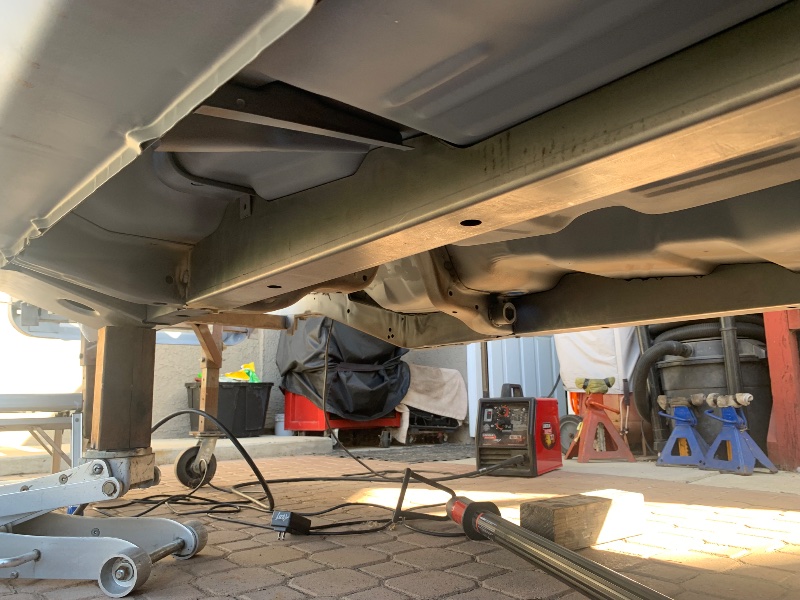

They look nice and all but after having done the installation with the car up on stands like that I wouldn't install a weld to floor set like the USCT connectors again unless I had the car on a rotisserie. It's just a pain in the ***, you've always got slag falling on you and it's difficult to maintain positions where you can actually see what you're doing, which certainly doesn't help with producing nice, pretty welds.
If you look close they are just tacked in place.
He’s going to put it on lift to finish because he’s done many before and it’s a PITA without a lift. It’s no treat with a lift. Lot of overhead welding.
He’s going to put it on lift to finished cause he’s done many before and it’s a PITA without a lift.
Yeah I saw that they weren't welded in yet and it gave me flashbacks to welding them into my Dart. Definitely not doing that again without a lift or rotisserie.
