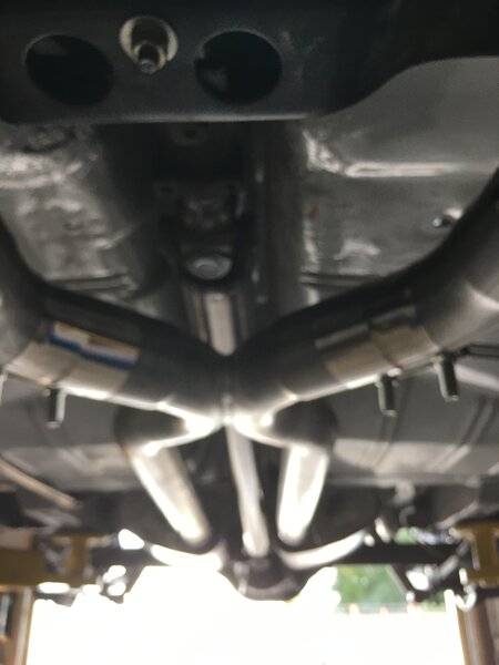

On my 66 cuda with factory 273 manifolds I have a TTI “x” pipe dual system with automatic. I went with the 2-1/2” system complete and Mike at TTI asked for the manifold numbers and made the compete system for me. Cost like $800 shipped to my door. No converting, no bs - but if I had to do again - I would go 2”.
SN- I did have to modify my trans cross member to fit passenger side. Directions to do that we’re in the box also.
SN- I did have to modify my trans cross member to fit passenger side. Directions to do that we’re in the box also. View attachment 1715583840
Very nice, Like you mentioned 2" would be plenty.
