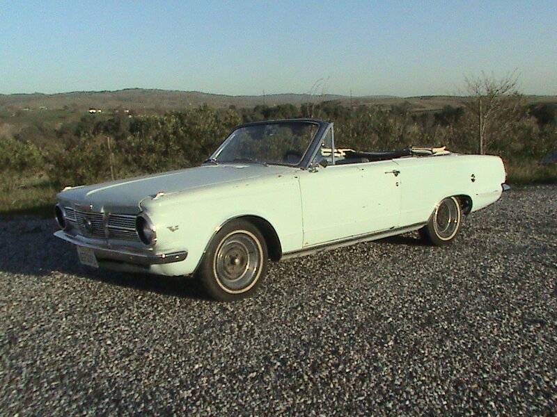

A previous owner replaced the factory gas cap with a push on locking one that is marked "non-vented". Is that the correct application for a '65 Plymouth Signet convertible? Thank you.
