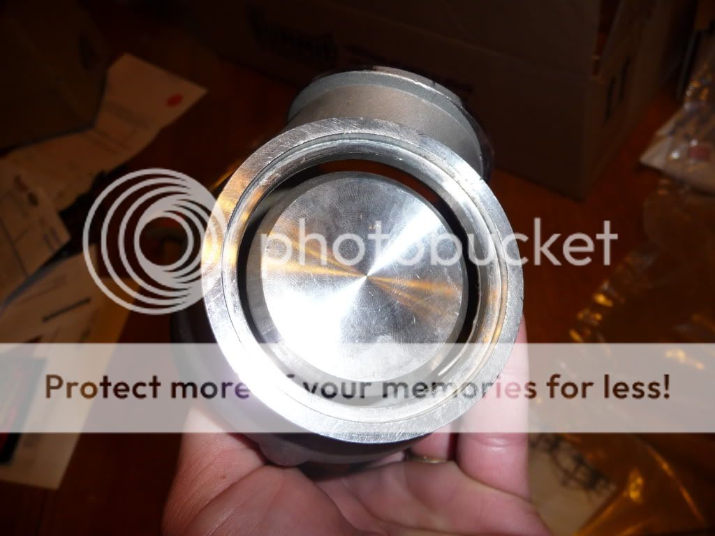

Just recieved my godspeed 50mm wastegate in the mail for my budget 273 turbo build and something doesn't look right to me. This may be a dumb question, but should the valve for the wastegate be a 1/4" diameter smaller than the opening of the wastegate? It should be sealed tightly so no exhaust gasses escape except when the wastegate opens correct?

Here's a pic of what I am talking about.

I'm thinking there should be a pressed in sealing ring or something? Don't know. The b.o.v. and turbo look pretty good. Got the manifolds, piping, flanges, carb, etc. Need some time to get this thing going.
Where is the flange that goes to that side of the gate?? Mine had flange that got welded to the exhaust and it uses a V Band Clamp to attach the Gate to that flange.
Post a picture of everything that came with the gate.
This one is the same way, but the flange in no way seals against the valve.
I have the same one Mad Dart has. It seals to the flange once its all bolted together. Yours looks like it should seal in the same manner!
Well according to the company I bought it from, in the package it should have had 3 flanges, 2 for the v-bands, and 1 that has an interference fit in the wastegate to seal the valve. I got all the other components I should have had, except the one flange that acts as a seal. Of course, they have not said if they are going to send me one, so I will patient alittle longer. I have tons of stuff to do before I need to worry about the sealing of the wastegate. lol.

I went through the same thing with the wastegate when i helped my friend turbo his truck. we were sitting there for a minute scratching our heads, my friend was about ready to put it on like that. I went and dug deep in the box and found it like wedged under the foam they put in the box. It would not have built boost very quickly without it!
So yes there is a little round thing that goes in there. check the box really good if you haven't done so already.
