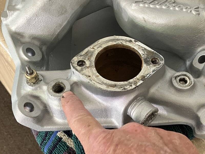

Hello, I’m putting together a 1990

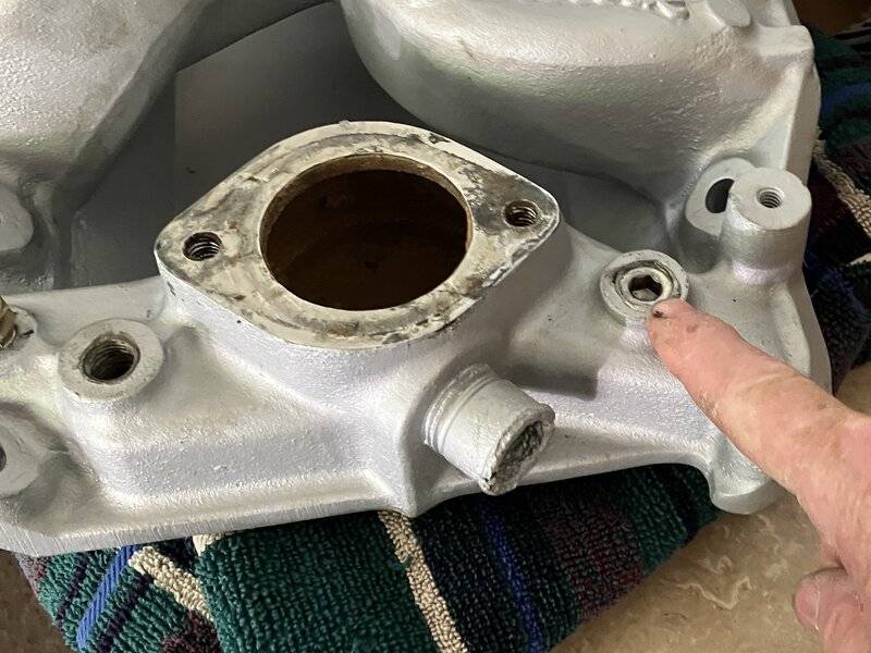

360 that came to me with the famous Edelbrock RPM Air Gap intake. I’m trying to figure out how to plumb it for e heater hoses. The prior owner had a hose nipple here:
That seems weird since then the hose would have to cross over the radiator hose. Other intakes often have a nipple here:
The problem with that is that the hole is smaller, like maybe 7/16”.
I put a plug in the threaded port on the drivers side of the thermostat housing along with a vacuum port behind the carburetor base. Is the smaller water port on the right side of the t-stat housing big enough to serve the heater? I don’t have a functioning heater in the car but would like to start making things work on the car.
Is it common to use the port in the first photo ?
Thanks. I guess that I could go ahead and do the same. It just seems a bit awkward to have it there.

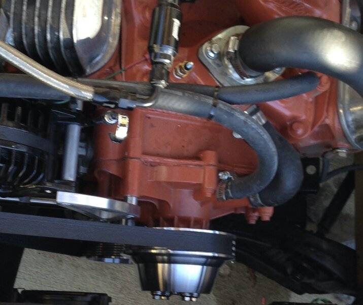

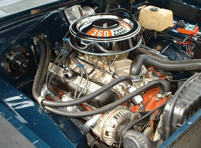

all of mine are on the passenger side of the thermostat housing. This factory heater hose router attached to the front of the head holds both hoses and is very convenient (repop available):

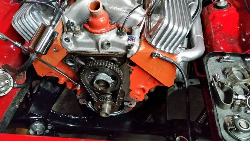

Same deal on my 65 Barracuda 340. I just noticed you said the problem with the passenger side boss is that its hole is smaller. I don't remember having to make that hole bigger for either of my two small block intakes. I just used readily available fittings for the heater hose and the bypass hose from the intake to the water pump. ???

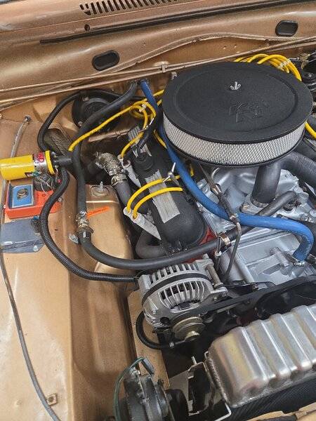

Many moons ago, I built a 64 Belvedere wagon, which had the heater core nipples coming thru the firewall on the drivers side. I wanted the heater hoses to go around the passenger side like normal, so I went to NAPA and bought heater hoses with pre molded 90 degree curves on one end and routed them the way I wanted them. Using a hose like that would allow you to hook it on the drivers side location and route it under the upper radiator hose. It would make a cleaner install and not kink the hose.
The manual says they come with 1/8,1/4 and 3/8 NPT holes so you would likely need a 1/4 npt to 1/2" hose barb. I'll have to look at mine and see what I was planning (final connections not finished yet).
7176, 7576, 75763 & 75764 q 1 - 1/8-27 NPT Pipe Plug q 1 - 1/4-18 NPT Pipe Plug q 1 - 3/8-18 NPT Pipe Plug

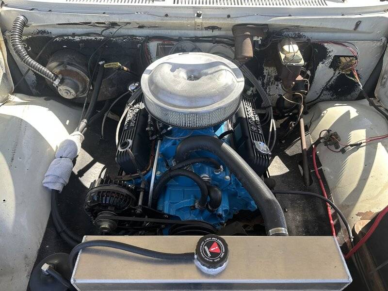

How I did the heater hoses on the magnum rpm air gap in my D100. Forgive the towel wrapped around the heater control valve. It drips and pisses me off.
