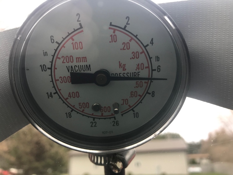

I'm working overtime to find new issues it seems. I was suspicious of high fuel pressure as I wasn't able to lean out the carb with rod changes in cruise mode. I don't have any other evidence that this is the problem as plugs look ok. I rigged up a temp fuel pressure gauge and got 7.5 psi. Edelbrock states 5.5-6 psi so it is a bit high...no idea if this would be problematic. I got a few options 1) bolt on my spare 30 year old fuel pump (output pressure unknown) and see what happens 2) install a Holley regulator ($100 plus hoses and fittings ) and try and figure out where to mount it while keeping the engine bay looking stock 3) pay $$$ ($320 up here!) and buy a 6 psi Edelbrock carb 4) follow @Bewy advice and lower the float level to 9/16" (found a 2 year old thread on this). I thought the issue was with the needle and seat? Anybody had a problem similar to this?

I just looked at carters spec sheets and the 60514 is max pressure 7.5 and the 6866 is 7... i came in at 6, so no idea.

Edelbrock clearly says 5.5 to 6 PSI and you are over that range. That would be the first thing I would correct. Have you thought about running a return line? That would likely drop the pressure right on Edelbrock's recommended range.

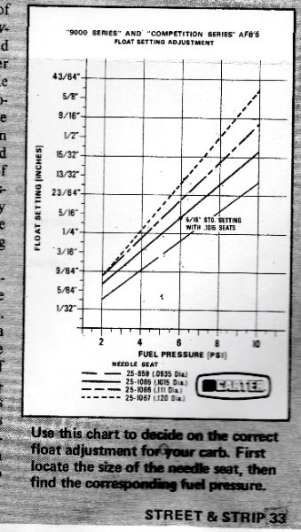

The fuel inlet of Carter & Edel carbs are IDENTICAL. Same n/seat, same float [ although Carter did use different shaped floats in some models ]. The parts can be swapped between brands. Here is the chart AGAIN. If you have 7 psi, that is FINE, & I would reset the floats to 1/2".

stock float height is 7/16" so something is different between these carbs. The blades are barely open (3/16" idle adjusting screw sticking out) and the mixture screws seem to like it at 1 turn out.
