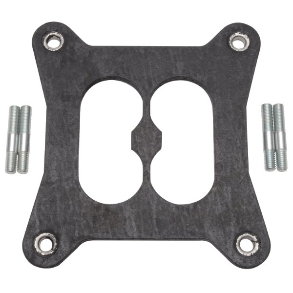

Not sure if are just using a base gasket under your carb, but if you are this heat insulator from Edelbrock cures a lot of hot start issues.
Edelbrock #9266
Edelbrock #9266
I put one on earlier this week. I'm thinking my hard starting issue is due to the distributor pickup....tba
