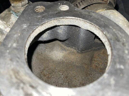

On the intake itself, not the housing. Picture below.

So, are the un used bolt holes leaking? They holes go through to the Coolant underneath? If such was the case, a female allen hex plug with Teflon sealant paste would be used to seal it off.

Looks like that could be. (bolt holes into the coolant) I also noticed the thermostat housing the op is using appears to be o ring sealed and may not seal over a open bolt hole. Wow that intake has plenty of open ports that have to be plugged for our old engines and cars.

Cant see the unused bolt holes going through to the coolant passage but stranger things have happened.
Btw. I am pretty sure the double bolt holes are for a/c cars and allow you to turn the housing & upper rad hose away from the a/c crap for clearance.
I have the same intake in the garage and will double check if the bolt holes go through to a coolant passage.

The 2176 has two sets of bolt holes and all are blind.

My Performer 318/360 intake although crusty and old like me, does not have cooling passages in either sets of t stat housing bolt holes.
1st two photos show what toolmanmike is referring to with the machined pocked (stock t stat housing).
Not sure if the billet one has this provision.
Photos 3 & 4 show bottom of all t stat bolt holes cast closed off. I can not run my pick down through any of the 4 bolt holes.
