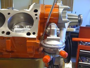

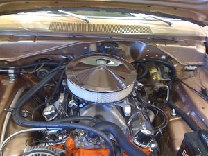

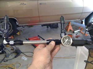

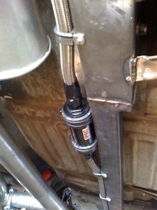

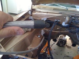

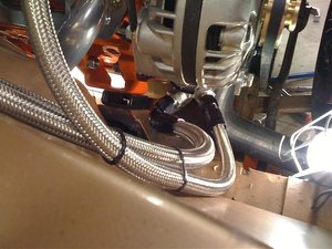

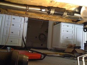

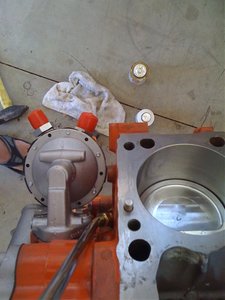

I am running the Carter that claims 172GPH no regulator required is the reason I chose this one. I figured if I was going to go with a regulator than an Electric fuel pump would have been called to duty. I used 2 filters 1 by the tank and one at the fuel rail. Was easy to mount only had to take a little bit off the block nipple for clearance. It uses 10 an inlet and a 8 an outlet. I also used a 1/2 inch pickup at the fuel tank. Here are some pictures.
Does this pump have 1/2 NPT for those fittings?? Most all Chrysler pumps ive seen have wimpy 1/4 NPT, fords and chevys HP pumps will have the 1/2 NPT,
No there is a 10 an inlet and a 8 an outlet. At the pump with the fittings off the inlet size is around 5/8 of an inch an the outlet is around 1/2 inch. I am sure you could change out the fittings with whatever you want or adapt them to whatever..........
