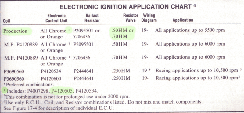

Thanks Dave, I think I have that same book lol.
From the MP bible Steve............
