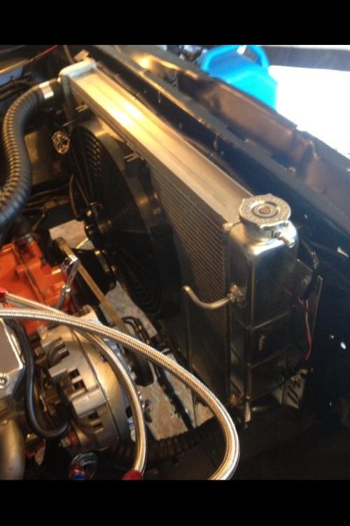

attachment.php
same set up as this one

I'd flip the fan around to front side of your radiator, real simple to change the direction of the fan blade to blow thru radiator, it should cool it just fine, also i'd center it in the middle of your radiator and let it cool, like i said mine at an idle goes to 160 at an idle and warms to 180 beating on it!!!!! the tie kits the sell at O'Reilly there like 6 bucks!!!!!!
Look at the Spal. There's room between the fans for the pulley snout and it moves 2750 cfm, keeps my 360/380 magnum below 210 at freeway speeds with 3.91 gears. Shrouds included and minimal cutting/fitting. It fits like it was made for the Champion 22.
