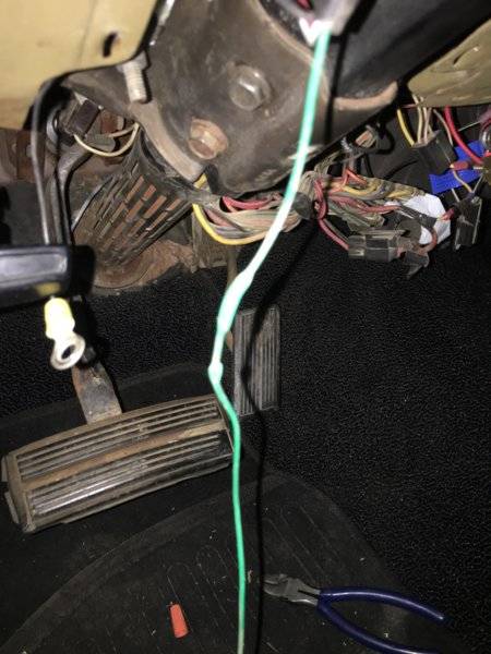

I’m not sure if this helps but I installed a new steering box and when I bolted my steering column back up I pinched my Rpm tachometer positive wire that was connected to my (+) side on my coil. It caused the car to not get any spark through the coil to the plugs. I took the green tachometer wire off the coil and car started right up..I installed a new coil, ecu, ballast resister before I finally figured it out. You might have something similar happening.
I have a tach wire that goes to the neg side of the coil. Someone else had said something similar so I disconnected the tach wire to the coil but it made no difference. Thanks for responding.
My tach wire is connected to the negative side as well I don’t know why I was thinking (+) Positive side.. lol..Opps.. Well Sorry it didn’t work, it was worth a shot.
