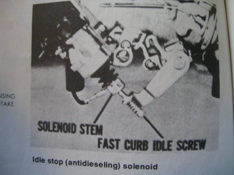

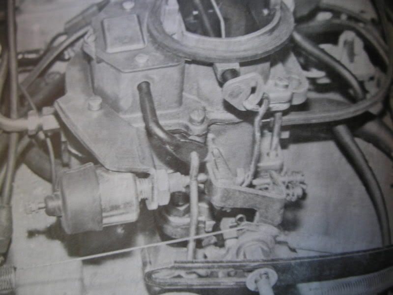

If you have a big cam and the idle mixture screws won't let you idle it down, the throttle blades are open too much. When you shut the ignition off, the engine can still suck enough air in to (barely) run and this pulls some gas thru the jets and engine heat sets off the mixture just like a diesel. The easist fix is an idle stop (anti-dieseling) solenoid that Chrysler installed on the mid 70s cars that held the throttle blades open at the the preferred idle speed. When you shut off the ignition, it de-energized the solenoid and let the throttle close completely.
You can also use an A/C idle kick-up switch from a GM 2 or 4 bbl. They were used to kick the idle speed up when the A/C compressor engaged. Most Qaudrajets have them.
