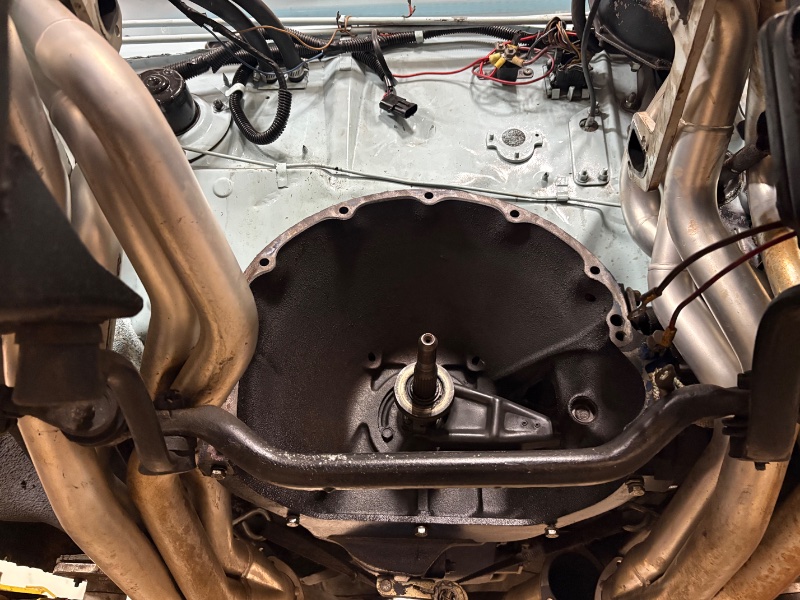

Engine is pulled - 273 rebuild or replacement 360 crate?
