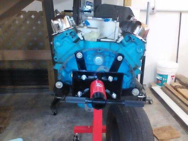

I had a pair of the 6 ton stands that were recalled so had to go to hf anyway. Got the 2000lb engine stand for $75 after the refund and 20% coupon. It is sturdy but still a bit of a kit. They weld the flange on the wrong end of the tube on top, but that can be corrected. It’s wrong in the pics online too. Pretty sure this one won’t tip over.
I dug this pic up from an old post, but I have my block mounted thusly with 3/8 bolts threaded in the holes at 11 and 1 o'clock and nuts and bolts in the through holes on the corners next to the dowels. Is this the "accepted" way? I don't want to shear something off when I turn it over. I'm half tempted to weld up a spider that uses all the holes but I have better things to do.
Opinions will vary but the original 340 to my car has been on a stand like that since 1985ish.... Just did another one that way...
