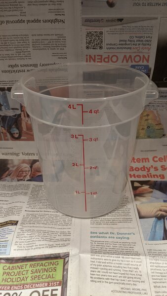

I love Evaporust!
But my wife has grown tired of me using her glass bowls for cleaning parts.
I happened to be in Sam's Club the other day and say these containers.
There are 3 for under $15.00.
They are a great size for small parts, nuts and bolts etc. they come with a lid and have handles on the side for easy lifting. Also they are a very thick plastic.

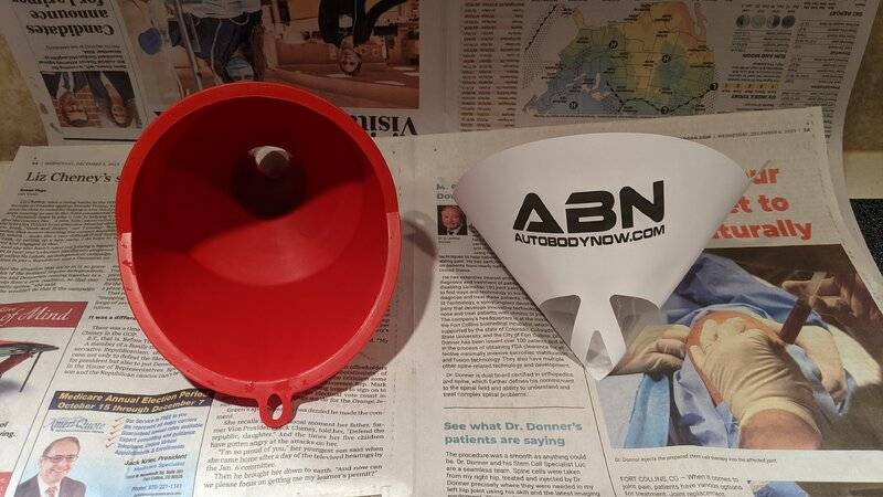

I also had a funnel and some paint filters and when I store the used Evaporust or swap out the parts I filter out the chunks.

I got some plastic food containers (something like Tupperware) and started using them for mineral spirits tubs. That really messed with the tubs. They first warped, then they got hard, then they cracked. I'm thinking about going to steam table pans, stainless with lids and not that expensive.
Amazon has two of them for $30
I sometimes use PVC pipe. You can try a 6” diameter piece with a cap for a valve cover.
A longer piece with a cap works good to soak driveshafts. Put the driveshaft down in the pipe with a wire rigged to pull it back out, stand it up with the cap glued on at the bottom and then fill it up with rust remover of your choice.
