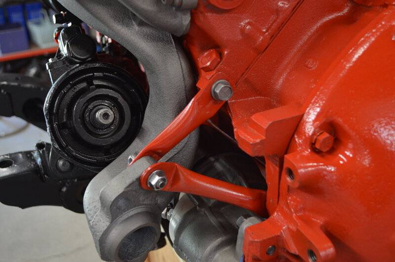

I'm looking for the two brackets that bolt to the bellhousing and the tail of the exhaust manifold on the left side. For my '65 F/S resto, I can't find them in the parts book, but here's what they look like. I'm not sure if these came on '65s, but they look like a good idea. (Photo credit to 68 Cuda Formula S for the picture).

Those were standard on 64 to 66 A-body cars with 273. Not 273 equipped B-body cars.

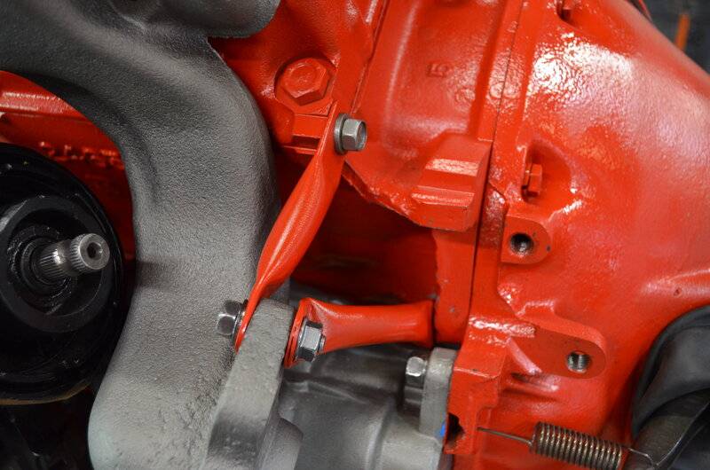

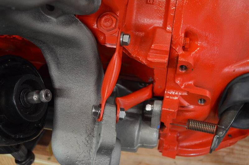

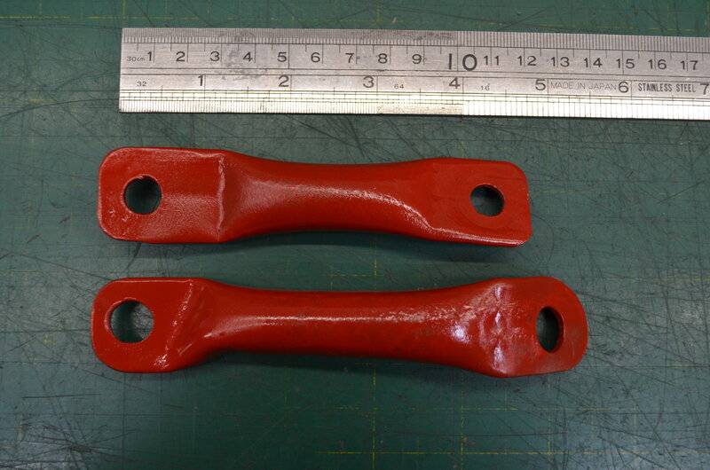

I decided to make my own brackets. I used 1/2" EMT conduit, which measures .70" O.D. A bit thicker than the originals, which are .60" according to a post by Hyper_Pak. The upper one went pretty fast, maybe 45 minutes. The bottom one took a bit longer, the first bottom one wasn't right, it interfered with starter bolt access, so I did a second (pictured). I used my big vice to squash the ends, and my drill press and grinder to finish them. The angles are tricky, and watch for adequate clearance above the starter bolt for a socket to fit. I'm beginning to understand why these are hard to find, they tend to get in the way, and they weren't replaced due to the lack of space. It's hard to get a wrench on the bellhousing bolt, and my engine isn't even in the car!
