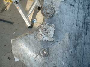

Wish I had the pics of a friends garage when his hot water tank air compressor blew. Not good. There are some things one shouldn't go cheap on.
