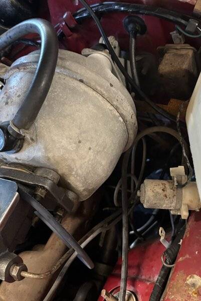

I’ve got a vacuum leak in the factory brake booster in my 67 barracuda, and I don’t have vacuum assist on the brakes.
I’m guessing there is a diagram issue. This type of booster is the 2 part booster held together by a removable band clamp.
Are these boosters rebuildable or does a guy need to take them to a pro to have them done?

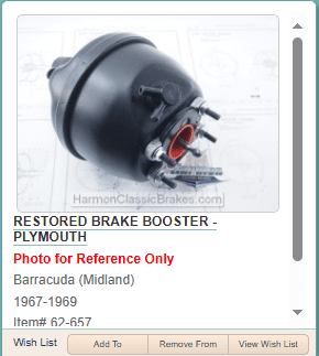

If you've got the 6 1/4" booster, I have not found a good source of hard parts, but they may be out there. Otherwise two good "Go-To" names to have them rebuilt are:
https://www.powerbrakebooster.com/
Home - Harmon Classic Brakes
They also are reliable sources for many parts.
