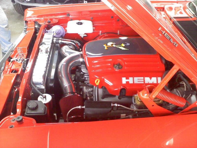

Gdemon,
THAT IS SWEET! nice wagon... I really like it. What is the intake from? Or is it custom?
JOE
I think he meant he modified the stock k-frame, not the TTI mounts.
