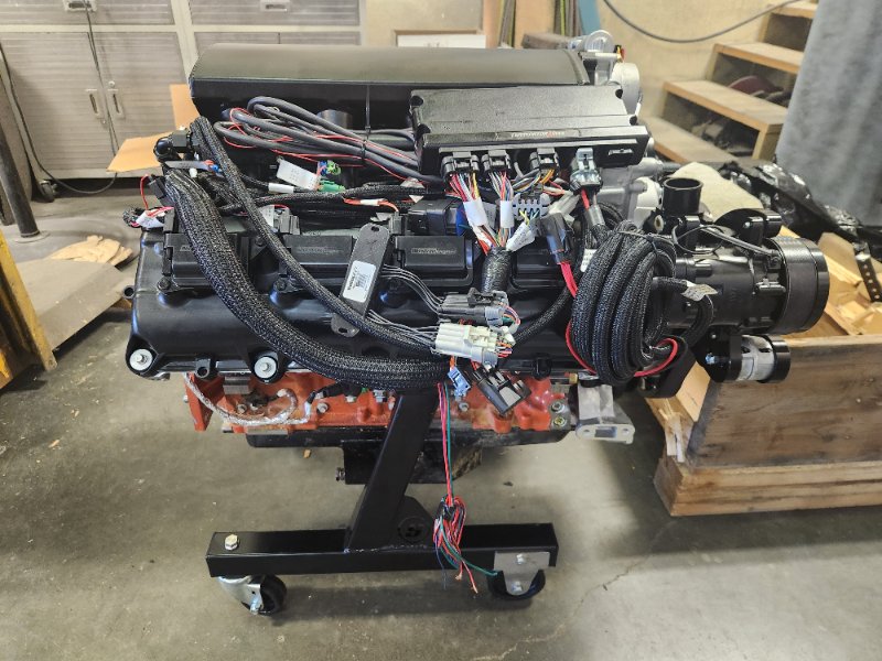

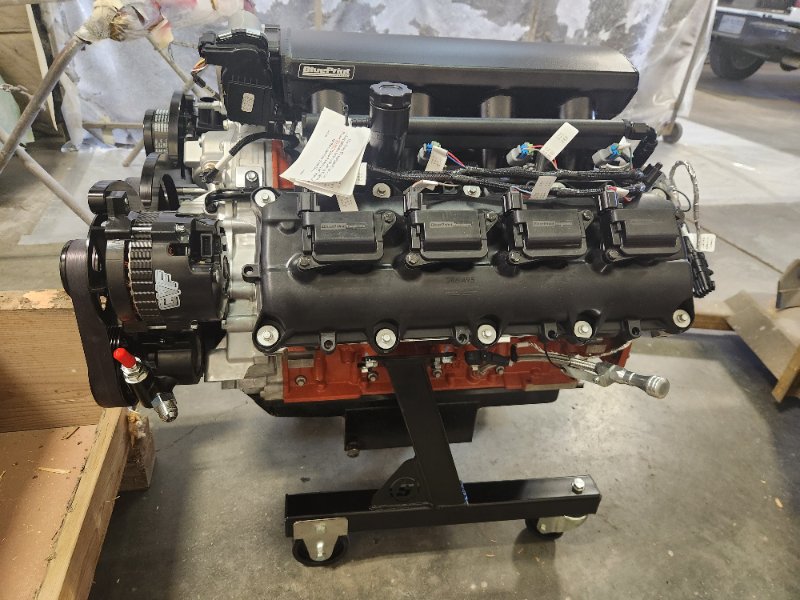

I have purchased the complete 426 hemi set-up from Blueprint (engine management, fuel injection and accessories). It's going into a 71 Demon with a 4L80E behind it. The Demon will have the new Hammerfab A-body Street Connection suspension. The car is at my buddies shop, he's the builder for this! Im going to start a thread on the build when he starts the suspension instal.
That’s bad ***.
Thanks Dee... my buddy lives 100 miles from me. I'm gonna swing by his place next weekend to check on his progress/motivate him!

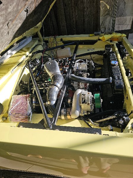

I already had bigger torsion bars, tubular upper control arms, adjustable strut rods, a sway bar, so the cost of those items would be offset to some degree with a full K-member upgrade with coil overs etc. I was already running all that stuff anyway, so it was easy and pretty much a bolt-in process to install a stroked 5.9 Magnum that puts out over 500ftlbs of torque beginning at 3400rpm and 820hp below 6000rpm with only 11psi boost. The Novi I'm using is rated up to 26psi, but I'm not going there.

I used a pretty much bolt-in stroked 5.9 Magnum that puts out over 500ftlbs of torque beginning at 3400rpm and 820hp below 6000rpm with only 11psi boost. The Novi I'm using is rated up to 26psi, but I'm not going there.
