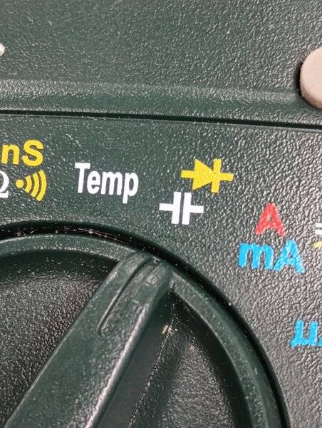

Some high end multimeters can:
If your multimeter has this setting, the condenser should measure between 0.2 and 0.4 uF. If you need to buy a meter anyway, look for a capacitance setting on the feature list. Not very common, but they're starting to come down in price and no longer something you need to get an expensive LCR meter for.
Let me clarify. That is NOT A TEST. Those caps need repeat MUST be high voltage leak tested to be sure they are good. WORSE, a cap that is actually somewhat low on capacitance but somewhat leaky and not shorted, can sometimes read HIGHER on a capacitance test.
Those capacitance testers are good for NEW caps to be sure they have the values as marked, or maybe you cannot read them.
Thanks for clarifying, it's correct that this test would not find a high voltage leak. It can pick up some other failures but is only applying a tiny voltage.
