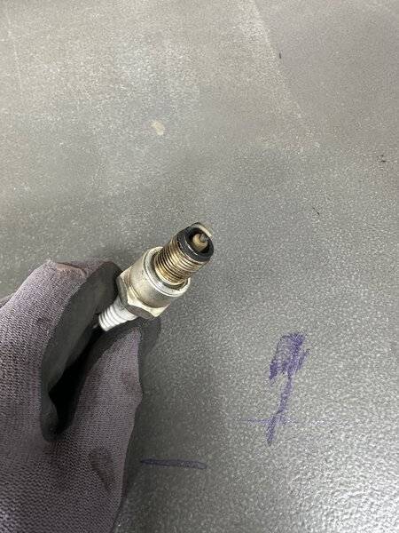

I did a compression check this weekend and checked plugs, below are those results and the only details I know of the motor mods. Also there is a pic of the plugs, all looked the same.
I found the #4 and #6 plug wires pulled right off the boot, so I’m getting a new set of plug wires and changing plugs while I’m at it. Also based on the plugs I’m going to richen up the fuel mixture a bit as well.

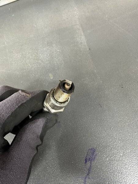

A few more pics
If you get 6 spark plug testers to 'look' at a plug to determine how the engine is running, you will get 7 different answers.......
Without knowing how long the engine was run, at what throttle opening, what load, how quickly the engine was cut....then it is nothing better than a good guess. And that is not factoring in the differences in today's fuels.
Those plugs look fine to me & not causing any problems. If they were black, sooty or wet......
But they are not.
