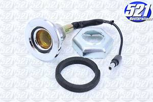

Kruisin' Moons reproductionproducts have the reproduction bulbs and lenses, as you can see there is a screwdriver slot in the lens, you unscrew it and take the bulb out. Make sure your leads are connected to the wiring harness in the engine compartment. The front marker light assemblies have a large sheet metal nut that attaches them to the fender, remove the lead and the nut then pull it out from the front, the bulb can be accessed by pulling the lead out, here is a picture of the assembly, they are available reproduction also, don't know the bulb number...

Post #2 pictures a marker light not a turn indicator light. Are your indicators mounted on the hood, not the lower fender? Picture?
They are chrome bullet shaped ornaments mounted on the fenders.
