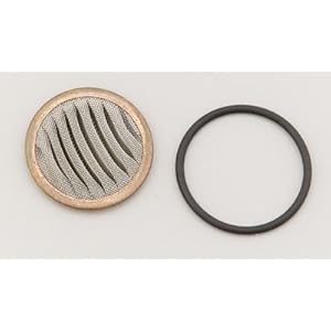

Right now, I have a Summit branded filter between the regulator and carb, which is supposed to flow 130 GPH, but it has a disc-type filter that seems to plug up all the time and might be a restriction. I'd like to put the filter right after the pump at the back of the car, where the temps are much cooler.

The reason I'm doing this is the carb filter that is currently on the car has a disc-type element that is about 1" across with very little surface area and just putting clean gas through it seems to be restricting flow.
The new filter has at least 10 times more surface area and should be less restrictive.
